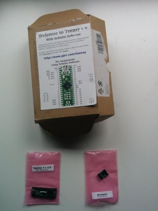

I have only got the box of my teensy 2.0++, which was a birthday present in 2013:
If I can reproduce the problem with the teensy 2.0++, may I get your help with my code, or is it also unsupported and I need to buy a 3.2 ?
Thank you very much, for taking the time to answer such a nap like me <3

Here is the 1:1 Version for arduino:
Platine: Teensy++ 2.0
USB-Type: Serial
CPU Speed: 8MHz
void setup()   {
