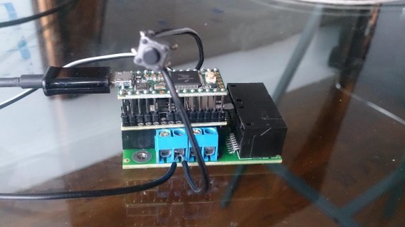

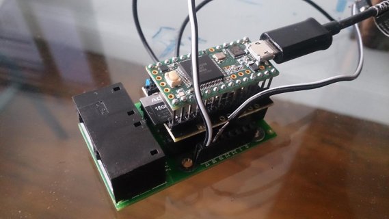

Hello, I am using a button connected to pin 17 to switch the name of the video bin file to play off of the SD card. From what I understand, the file name changes correctly after a button press, but then after the first 512 byte buffer, the first byte is not "*" so it keeps closing the file and reading from the wrong location again.
I've added a few lines for debugging, so you can see the problem when this line, which should always be "42" for the "*" is a different number:
5 byte header can be read. first byte: 0

Which PJRC product you're using
Teesy3.1 + OctoWS2811 + SD card reader
Part numbers of any other chips or modules + links to their info
Simple tactile button
Wiring details - how exactly have you connected the hardware (a photo's worth 1000 words)
Software setup, Arduino vs C+makefile, running on Windows, Mac or Linux?Versions?
Arduino on Mac
Any other information needed to reproduce the problem.....
The ethernet cables aren't plugged in right now, but those are working fine. I'll add them back once the video presets are updating on button press.
