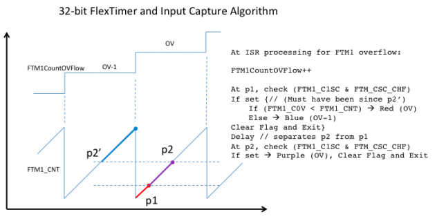

I think I have this figured out. When the FTM overflows and an input capture occurs nearly simultaneously, it is difficult to know which occurred first, and therefore if the pre-overflow or post overflow counter value should be used. My solution is to compare FTM1_C0V and FTM1_CNT at the interrupt; if C0V is lower, then the capture must have occurred after the overflow; if it is higher, then it may have occurred before. The way to decide that is to delay some small time, and do another check. This check ensures that the possible FTM1_C0V in the earlier test is clearly greater than the FTM1_CNT at that test time. A diagram shows the process:
Here is some code that implements that. It is probably possible to optimize the ISR.

extern "C" void FASTRUN ftm1_isr(void) { // Process CHF first, unless counter is close to overflow
 if (FTM1_SC & FTM_SC_TOF) { // read the timer overflow flag (TOF in FTM1_SC) rate = 10 MHz/65536 ~ 152 Hz, 6.6 ms
    FTM1_SC &= ~FTM_SC_TOF;   // clear interrupt from timer overflow
    FTM1CountOVFlow++;
  } // TOF
  // now poll CH0 and see if it had any activity
  if (FTM1_C0SC & FTM_CSC_CHF) { // rate = 1 pps
    FTM1_C0SC &= ~FTM_CSC_CHF;  // clear flag from channel
    CaptureFlag = true;
    if (FTM1_C0V < FTM1_CNT) {CountValue = (FTM1CountOVFlow << 16) + FTM1_C0V; return;} // very rare - just happened since interrupt
    else {CountValue = (FTM1CountOVFlow << 16) + FTM1_C0V  - (1 << 16); return;} // from 10 us into previous cycle
  delayMicroseconds(10); // to split the interval -- should be longer than max. interrupt latency
  if (FTM1_C0SC & FTM_CSC_CHF) { // try again, now 10 us into new cycle; good if no other interrupts are > 10 us
    CaptureFlag = true;
    CountValue = (FTM1CountOVFlow << 16) + FTM1_C0V; // happened between just after start and 100 us into cycle
} // ISR
