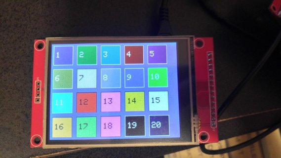

Implemented Code suggested in post #25: User code loops and draws colored buttons on screen.
USB Prints the needed struct data to match it with simple buttons.
Putting that struct data back into code uses it as modified
Button #1 rotates screen clockwise, buttons are redrawn and those buttons leaving the screen are clipped.
The struct version in the code on GitHub currently clips 8 buttons in portrait, the USB output shifts buttons left and only 4 are clipped when in portrait layout. If you take the structure output and replace in the sketch it will change that.
ColorButtonsTest/ColorButtonsTest.ino
All displayed buttons will respond with Serial.print of the button number.
Constant press on SAME button registers once until 50ms between touches
SWIPING the buttons will register them in turn as pressed

Really Nice Work!
Working well on Teensy 3.2 with Arduino1.6.6 & Teensyduino1.26-b3
Also works with the enhanced ILI4391_T3 Fonts I'm using DroidSans_24_Bold

Rfresh737 & Wozzy - Thanks. Did you try it - with the INT code or without? It works 'the same' both ways - but no SPI noise trusting the touch int.
Wozzy - Looks nicer with your font. Let me know if you cut and paste the left adjust into the code to see the button clipping. Did this on the way to making an alpha keyboard and other edits - started there just to answer the prior post.
Run a pressure display example like TouchTest and watch the pressure as you touch - let me know if there is any usable info there.

Will add a FONT size to the per button struct - will leave it up to the user to set the font as you did.
When I look at the p.z it varies wildly from side to side and top to bottom even doing your best to maintain constant pressure. It is a function of the cumulative resistive value across the X and Y planes so it varies - it would take a serious mapping effort to plot that and then apply it dynamically. For a given point yes, more pressure higher value - less pressure lower - but not edge to edge consistent in any way.
In that sample I pulled the ILI9341 color table into the array - the colors displayed are not all unique or in keeping with their names. I did math
(array_colors[ kk ] & 0xFFEF ) > 0x8419 ? ILI9341_BLACK : ILI9341_WHITE
to pick the forground color based on how 'white' the color was. I'm not sure my math is on the right 'bit field' boundaries - but it works to pick white or black in some general fashion as show in the pics.
