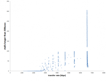

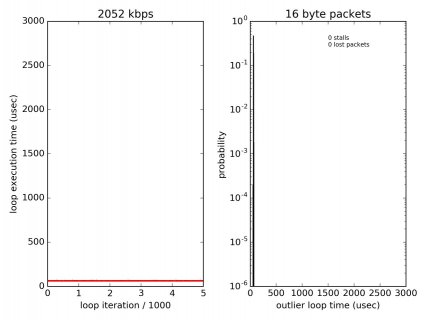

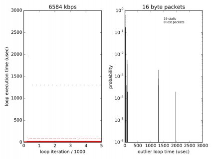

I have completed my benchmarks. With optimized python code on my desktop I can get ~6.5Mbps average transfer rate if I'm willing to accept a variable loop time, or ~2.0Mbps if I want to avoid blocking. I don't think the packet size fed to Serial.write matters very much, other than the overhead in packet encoding and the lost data efficiency due to the COBS/parity/CRC overhead.
Here's what a 6.5Mbps transfer looks like:
and a "safe" 2.0Mbps transfer:
I counted a loop that took longer than 300usec as a "stall". Here's how the stall rate per 5000 packets grows:

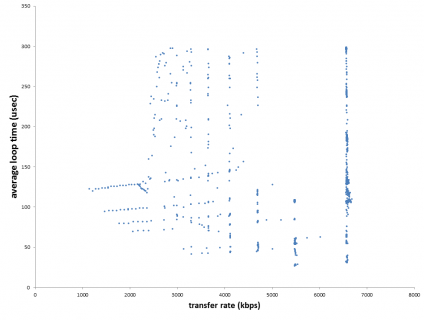

Finally, here's a plot of the average loop execution time vs. data rate:
Here's the code and a csv for the test conditions in the plots:
View attachment teensyserialtest.zip
I've also run some tests using Chrome.serial or a compiled go program as the listener. Both are anecdotally faster than PySerial but I haven't been thorough in benchmarking. I'm particularly excited that Chrome.serial is fast since I will be ultimately be using it in an extension for my product (Flybrix).
Write sizes shouldn't matter, other than consuming a little more CPU time. Teensyduino's USB serial code packs your writes efficiently into 64 byte packets, regardless of their size. Partial (inefficient) packets are only transmitted if you call Serial.flush() or Serial.send_now(), or if you stop writing for 4-5 milliseconds. After a 5 millisecond timeout with no more Serial.write(), whatever partial packet was in progress is transmitted. The main purpose for Serial.send_now() is to cause that last partial packet to transmit ASAP, rather than 5 ms later.
