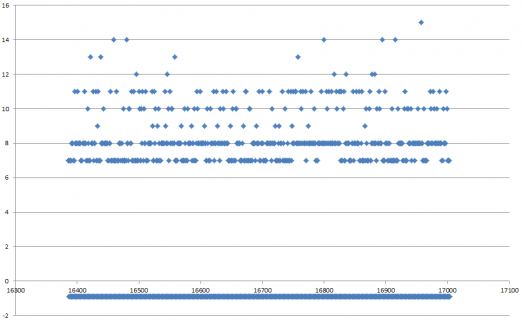

Like many others, I'd like to pull data as quickly as possible from my Teensy 3.2 and want to figure out the best strategy for Serial communication.
I know I can get better effective throughput by changing my code -- by sending binary data, being careful not to send redundant info, etc -- but here I am sending plain text to keep things simple. It is possible that my python listener code is causing problems and needs to be in a separate thread or should read data bytewise using PySerial's in_waiting rather than readline().
I am using windows and the Teensy USB serial driver.
Basically I don't understand:
1. the difference between send_now() and flush()
2. why I get a "corrupted" data stream using just println()
3. why I can't manage more than about ~300kbps (or ~1Mb/sec if I try to manage the corruption)
I've attached my sketch and a python script for reading and parsing the data.
The results look like this for me:
  • teensyserialtest.zip
Here is an example of the "corruption" I mentioned:

This snippet shows 3 good messages and then a garbled message with a ~120 msec jump in the timestamp.
I see this a lot when using println() alone.
When the jump occurs, note that the loop iteration counter is incremented from 597 to 732 -- so my loop is still running and I'm still presumably making calls to println() -- this data seems to just be "lost" somewhere...

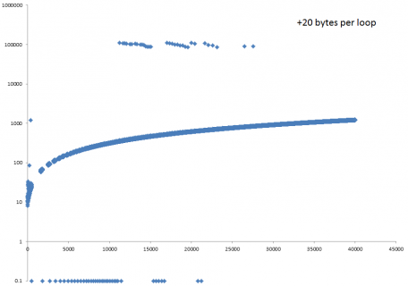

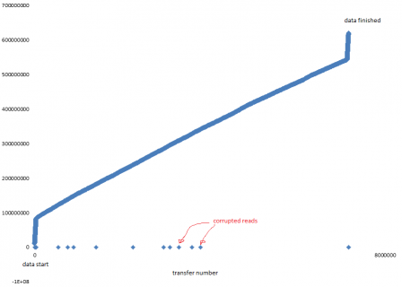

Some statistics on the dropouts using send_now() -- In ~262k transfers I got 180 corruptions.
The errors seem random...

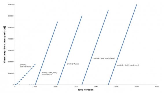

I am returning to my minimal code example because I seem to have some other timing weirdness in my MPU9250 data collection loop.

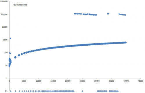

Just to re-establish the problems I am seeing:
When sending data without calling the "send_now()" function I get significant data dropouts. I lose almost half of my 20byte writes while sending 20k iterations over a ~5.13sec time period:
I seem to get no (?) dropouts calling "send_now()" inside my loop, but now it takes me ~20sec to send the 20k writes:
The loop time seems to increase after the first ~10 iterations (corresponding to about 200 bytes of data being sent over serial USB)...

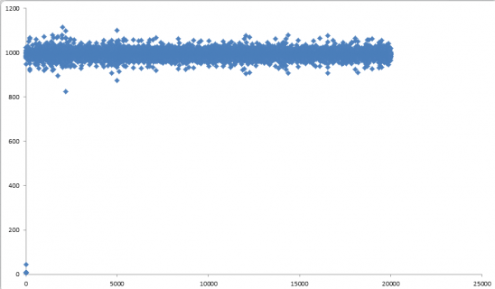

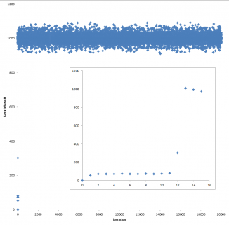

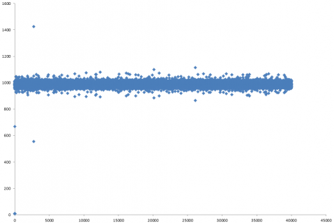

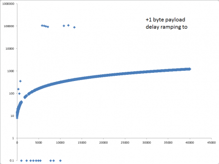

Here is the progression of timestamps when we call Serial.send_now() inside the for loop:
and when we do not:
I think the results are essentially the same -- we lose data without send_now()...

The delayMicroseconds() required to reduce dropouts seems dependent on data writing rate. Also sometimes the loop takes significantly longer to run:

I think the "very long loops" may also be related to serial comm issues.
Sending +1 byte of data as we ramp up to 1200usec delay per loop:
Sending +20 bytes of data per loop:
Note that the dropouts are worse whenever the data rate goes up.
