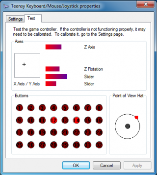

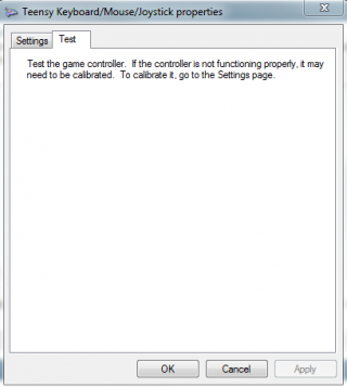

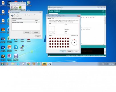

I read the guide but it didn't seem very relevant to the actual code I'm using. The joystick shows up in joy.cpl, but the window is empty, I'll show you what I mean.
Here is a normal window: td_joystick_sc3.png
Here is my window: 2016-02-09 19_08_32-Teensy Keyboard_Mouse_Joystick properties.png
My arcade stick shows up in Devices and Printers as "Teensy Keyboard/Mouse/Joystick" but when I go into the settings it is completely blank for some reason, I have no idea why. I have it setup as a USB joystick in Arduino, and it looked like this before I modified any of the code in the example, so I didn't cause it as far as I know.

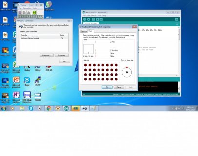

Its wierd about joy.cpl ...it seems to be seeing the device ...do you need to press OK, or is there a setting .... Its just weird, and I am not familiar with joy.cpl at all ...

I just tested the code I gave you on my mame arcade setup ... I compiled the code (no mistakes!!!) for my teensy 3.1 ...put in the pins I have connected my digital joystick to, and .... it works fine...indeed on joy.cpl I can move the plus sign around with my joystick ....
diagonals work pretty well!
Im on windows 7.... perhaps you need to tell us more about your setup ... are u using a teensy 3.x ... are you connecting through a hub (shouldn't make any difference...) ... can u upload blink, are you getting serialprint data on the arduino ide serial monitor? are you getting hid devices appear in windows device manager
View attachment 6348View attachment 6349
I'm using a Teensy 2.0 with Windows 7, I'm getting serial print data, HiD devices show up find in the device manager, nothing else works. I have no idea what the other guy meant by HiD descriptors, I have no idea why nothing is working. I'm not using the many axis joystick file, I'm using the stock example complete joystick modified for certain pins and functions.

I can't imagine what would be wrong, it is a teensy 2.0 being coded in the arduino software on Windows 7, functioning as mouse+keyboard+joystick, same code you're using that you managed to get working. Probably one of those classic Windows super picky registry/driver issues that basically doesn't make sense. I'll make a new thread about that particular issue and see if someone can help me out.
Okay so I got everything working so far except the joystick, all my buttons are registering in joy.cpl in correct order and seemingly flawlessly, everything basically seems to be operating correctly besides the fact that all the joystick currently does is automatically rotate in a circle. Which code am I supposed to use to get an 8-way digital joystick working?

My joysticks switches are: pin 15 = up, pin 14 = down, pin 13 = left, pin 12 = right.
Its going in a circle because of the pov hat code ... try the code from my post #32 and tell me how you get on ...

Seems to work fine in Street Fighter, although for some reason some software reads the inputs differently than others, so say for USF4 it will decide that the fourth button on my top row of buttons (button 5 as the software says) is the button that is supposed to be used to select things as if it is the "X" button on playstation or the "A" button on xbox. If I change the code so that button 5 is actually where the software thinks it should be, suddenly it decides that button 3 should be used to select things, I have no clue why. Other than that it seems good though.
I would definitely rather have a hat switch if I could get one working, not sure what code to use or if it will ever end up making a practical difference, but it just seems right using what is effectively an 8 way hat as a hat instead of a simulated analog.
edit: it works natively on PS3 too!
DrVinnys approach will work for an eightway hat... If I get some time I'll try yo write some code for you following DrVinny's suggestion...
Try this ...I've commented out the serial print for the buttons since you have joy.cpl working!
