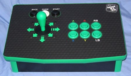

Are you saying you have an oldschool arcade stick, like a 4 way or 8 way stick for MAME or something? Otherwise you will need that code! It is for a proportional joystick, I think. Even if you have an oldschool stick, I would suggest you may need the code to get the joystick working!
voltage 3.3V as off and voltage 0 as on still would work with anaolog read I would think ... Isn't there a page on joysticks on the pjrc home site?? i bet somoeone has used the joystick you have with the joystick library ... I haven't, so I'm not much use really ..
It looks like this with one extra button total. I have searched for arduino code I could adapt for what I'm doing, but I wired my PCB in an unconventional way hence why I made this thread, that and the fact that I want to learn to program a little bit makes me want to adapt the example rather than somebody else's code. How do you trick the code into thinking the digital switch is analog?

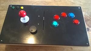

what is the part number etc of the joystick ...looks very mame-like... I made one myself!! For defender (the joystick is 4 way digital)
I can give you code for my controller if you like ...what it does though is spit out key strokes to control mame (so press button 5 and you get the letter A over USB, and MAME interpretes that as 'fire') ... in other words it does not appear as a USB joystick type, but as a keyboard!!
What are you trying to control?
Happ competition joystick and pushbuttons. I have 3 arcade sticks, with all 3 major companies, so a Sanwa japanese stick, a Seimitsu Japanese stick, and this Happ American style stick. Keyboard strokes are really preferable for MAME, I've tried getting some of my other arcade sticks with proper PCBs work on MAME and it can be a total nightmare sometimes, however my main goal is to get to natively interface with PC fighting games like Ultra Street Fighter IV and the like, so making it interface as a keyboard actually makes things more complicated rather than less, although it tends to be more reliable.

just a thought ... maybe the strange jitter you are getting is the pov switch 'revolving'
I had a similar issue a few years ago. Instead of hard coding the buttons individually. I went with an array that allows you to put the joystick buttons in any order. All you have to do is put the pin number in the order you want the joystick button to be. In my code below you can see I wanted Pin 31 to be joystick button 14. Hence 31 is the 14'th value in that array.
