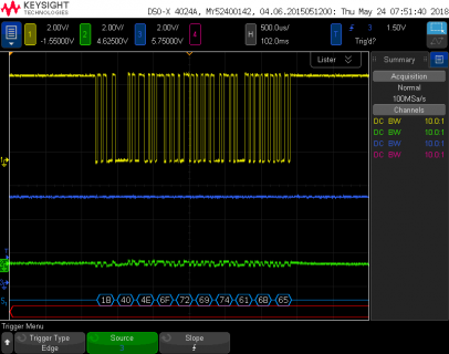

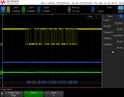

Since I don't have this display, I was only able to verify using my oscilloscope. I tested with the "Hello" example on this line uncommented:
GE7000_Serial_Async interface(38400,3, 5, 7); // BAUD RATE,SIN,BUSY,RESET
Here's the output running on Arduino Mega.
Here is the output running on Teensy 3.5 at 120 MHz.
