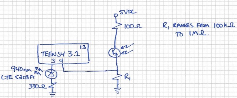

I am trying to build a very simple proximity switch where four (4) sets of LTE-5208A 940nm infra red (IR) emitters are each paired with a LTR-3208E photo transistor (NPN) for a model railroad project I am working on. In this project, there are two tracks parallel to one another, and there is a proximity switch (for lack of a better description) on the left side and the right side of a railway crossing for each track to detect when a train comes from either direction... and when the level crossing is clear. The small Teensy 3.1 is perfect to perform the necessary logic and make the lights flash appropriately.
I have loosely based my design on the following references:
With the following circuit (see attachment), I am able to get a fluctuation in voltage of almost 0V to 0.1V… and if I increase the 100kohm to 1Mohm, then I get almost 0.5V to input pin #4 as measured on a MultiMeter… but this is not obviously enough to trigger the input.
I am not an expert by any means with electronics and have two questions:
  1. Is there any way to do this circuit with out a NPN transistor such as a 2N3904. Can one do this with one transistor given the input is transistor based, or do you need a darlington pair.
  2. What is the required voltage to trigger a digital input on the Teensy 3.1
The code for the program is quite simple and looks as follows, using the on board LED at pin 13 as an indicator for test purposes.

Change the digitalRead to analogeRead https://www.arduino.cc/en/Reference/AnalogRead
And use an analog capable pin (14 and up) https://www.pjrc.com/teensy/pinout.html
with a 0.5V signal you should be able to use a if (analogRead(A0)>150) to drive the logic. That 150 is based on the max value being 1024 for a 3.3V input, so 1V = ~620 and 0.5 should read ~310. If you want you can get clever by reading with the LED off to measure background, and with it on to sense which may allow some basic range/shape detection.
Alternative is to add a transistor as an Amplifier, along with some bias components https://en.wikipedia.org/wiki/Bipolar_transistor_biasing
This will allow you to have more inputs, but complicate your circuit. In fact if you are trying to save component count try pinMode(A0,INPUT_PULLUP); with your light sensor connected to ground and A0/14 and no other components. Dynamic range will be pretty poor but may be 'good enough'.

Thanks to all that responded. With a few minor tweaks, specifically using the Analog I/O as recommended by GremlinWrangler, it got this working. The changes to the circuit posted above are as follows:
  1. Utilize pin #14 (analog A0) to detect signal from the LTR-3208E photo transistor (NPN) as an analog value rather than discrete on / off.
  2. Decrease the resistance of the resistor going to the LTE-5208A 940nm infra red (IR) emitters. Using a 100 ohm resistor instead of a 300 ohm resistor, noting the the LTE-5208A has a 1.2V drop and the output from Teensy pin #3 is just over 3.1V, increases the current from 6.4mA to 16mA. Now the light output is sufficiently bright. Note that I used an iPhone4 in selfie mode to confirm the IR is working.
  3. Change the circuit from one where the emitter and photo transistor are side by side and reflective to one where they are across from one another and create a beam that is broken when an object is in-between.

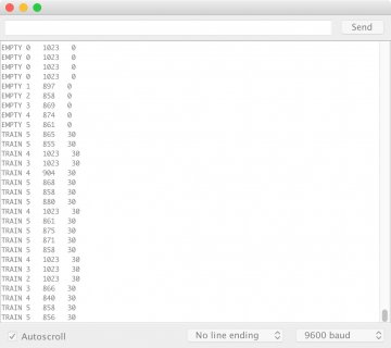

This design provides one with a 1023 analog input (max) when there is nothing present and drops it to about 820 when blocked. I added a counter that makes sure that, in this case a model train, is detected multiple times (TRAIN) and then the track stated to be empty after the infra red sensor has detected the track is clear multiple times (EMPTY)
The revised test code is as follows and a screen shot of the serial output is also attached.
