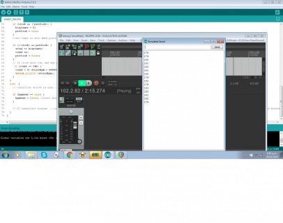

hey again,
@pensive: sounds great! you probably already have the code, but if not the code above does give you the clicks. :)
so, i havent made any progress so far.. i really just need to be able to get a millis measurement from the if(counter etc..) function into the main loop,
the main void loop doesnt register measurement in those functions, so i cannot subtract the two events from each other to calculate the bpm according to the time events.
ideally i would prefer to read the bpm directly from abletong, but even measuring it from the clock events would be very helpful.. does anybody have any ideas?
did i explain the problem clearly?
thanks!

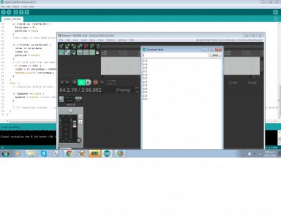

hey mortonkopf, thanks, for the post!
i tried the code, but to be honest im not understanding it completely and i am not sure how it helps me recover the bpm since i dont really see the difference to the version i used before, at least in terms of my problem.
the serial gives me a "248" message in time with the ableton clock, but thats what i already had before too.
however, what i need is to print and save the exact ableton bpm value in the serial (as in ableton is running on 140 bpm, i want my serial to say we have 140 bpm, if i change it to 130bpm, i want my serial to say, oh, its 130bpm). so my idea is since i cannot seem to get the value of ableton directly, i could calculate it according to the clock, measure two time events according to the arduino clock, subtract them from each other, put that in an equation, and then calculate the exact bpm. i guess this is unusual since most people just want to sync their arpeggiators or drum machines with ableton, so they only need a click that follows the ableton bpm, but again, thats just a click, not the actual bpm. what i build is a gestural midi controller, so basically, when i move my arm or do a type of matrix move the bpm slows down (im using ableton loopers so there is an additional slow down sound-gets-lower vinyl effect so it detunes the loops down). now, when im done doing this and i deactivate the bpm manipulation i want ableton to jump back to the exact same bpm level before i activated the gestural ctrl change (so the loopers are back on the same exact speed and in tune with my external instruments otherwise the whole song is fucked up..). i tried to do this with sending ctrl-z redo message, which kind of works but of course easily messes things up if i do anything else meanwhile, like change other ctrl values. easiest thing would be if i could exactly control the ableton bpm. that doesnt seem to be possible (maybe with maxmsp but id like to keep it simple), so my thought was to calculate the exact bpm value according to the clock, save it, apply the ctrl change and once i deactivate the controller have it reset the bpm to the value before it started changing it, the loops go back into tune and i continue the song.
now this is my problem: i get the clicks, i get the sync and the clock works fine, but whenever i try to measure millis time points in those "counter"functions and use them in the main loops, i get nothing back from the variables. i would just like to have a simple: if (click of clock happens) set click1 to, if it clicks again, set click2, subtract from each other, whats the bpm right now, save that, etc. so, i dont understand, when i change bools in the lower functions, why dont they change when i check them back in the main loop as in the code i tried above? probably its just because of my very limited understanding of c++...
(maybe the solution is already in your code, and im just not getting it, in that case im sorry :) )
ah. The code I posted was only to show the switch between ableton generated (Teensy receiving) and Teensy sending (the if / else part), showing in a rudimentary way how both can be active. I will have a think about the measurement of bpm.
Yeah, well i will definitely save your code it for possible future use (if that is ok), but for now i just need to be able to measure the time interval between two successive clicks. I really dont get why i am having such a hard time doing that..
just a thought, cant test at the moment, but what about replacing if(realtimebyte == 248) { Serial.println(248, DEC); etc... in my code above, with something like:

So I tested the code above in #20 and it works after a fashion ... The serial monitor output tracks the bpm, but unless it is a really low bpm (like 50 or less) its quite inaccurate ...
I suppose I am 'serialprinting' the bpm each blip, so at high bpm, there is a lot of serial print action .... I tried adding up every 24 blips and then printing, but that didn't really help accuracy at high bpms ...so I suspect the base problem is the accuracy of my sequencer's clock at high bpm ... I'm pretty sure that the teensy can clock at midi serial speeds....
I will muck around some more .... give it a try at low bpm and tell me how you go...
Edit: I wonder if in addition to the near certainty that my sequencer clok is inaccurate whether there are usb / serial interrupt type issues at high bpm (but I worked it out to be around 50hz clock for 120bpm 24 blips in .5 of a second!!).... could serialprint be a queering factor along with usb type things which I don't have a clue about at that speed???.... will look at it further.
Another 10 minutes... another post ... So I have updated the code in #20... I shifted the serial print, and 'analysed' the clock (and printed/stored) over a much longer period ... 20 beats instead of 1/24 of a beat ... and I'm getting a pretty accurate serialprint of the sequencer's bpm ... (that is, accurate for my sequencer, setup and midiclock generally) ... about +- 2% at higher bpms... As good as others have reported on my platform.
Yay! Photies ... one at 120bpm, the other at the correct speed for rock and roll ... 180bpm
