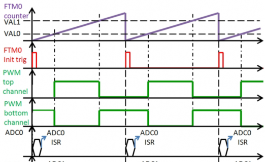

This is the actual timming I'am looking for:
(except the PWM bottom channel should be low during 100 cycles then the PWM top channel will be low for another 100 cycles and so on).
