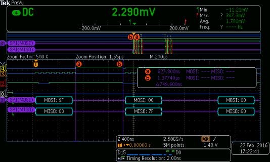

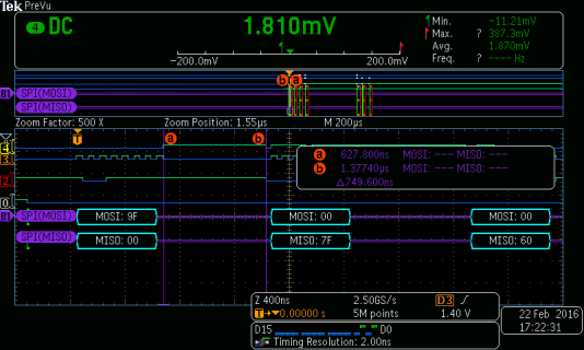

I double-checked all wires are hooked into the correct MISO/MOSI/CS/SCLK, as well as GND & Vcc. I then hooked it up to an oscilloscope, and was able to produce the following scope screenshots:
Only once out of about 10 times was the scope able to read the correct values for the sequence, which should be: MOSI 94 00 00 00, then MISO 00 EF 40 18. The scope is configured with the following assignments: D0->CS, D2->MOSI, D3->SCLK, D4->MISO.
My best guess is that the memory chip, as soon as it receives the 94 (read ID) command, latches on the value for the first clock cycle for the data return, a 1 for the MSB of EFh (cursor a), and then after about 700-800ns without a clock cycle relaxes to 0 (cursor b). This code was likely developed and run mostly on a Teensy3, which has a higher clock rate, so the intervening 700-800ns between SPI data transfers would be reduced, so this issue likely would not have been seen. Can you confirm or provide possible solutions?

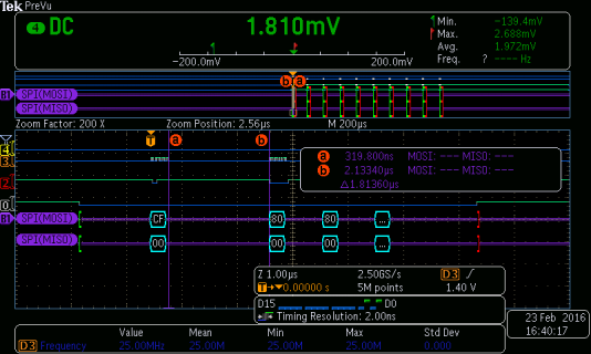

This method produced the correct ID every time, which no other method was able to produce. However, the delay in ending and switching transactions is about 2 microseconds, which is extremely long for what should be just flipping a bit in a SPI Control Register. If I need to, I can manage with modifying the SerialFlash library to flip phase between reads and writes, but I would prefer to find the SPI control register and write that directly. Paul (or anyone else very familiar with embedded) Is there any problem with writing the SPI control register between transfers? If I could do that, using a simple inline toggle function, it would drastically cut down the switching time while still providing the read accuracy I can't get any other way.
Below is a scope screenshot demonstrating the delay between sending the first command and then switching phase as in the above code. The data passed isn't correct because I was messing around with using SPI_MODE1 for both transactions (and somehow forgot to get a screenshot of the working version), but it does demonstrate the 1.8 us delay. I suppose you'll have to take my word for it until I can get back in the lab tomorrow to prove that it works.
I guess I will have to work on finding a solution to toggling the clock phase control register, unless anyone else has any suggestions or a better way to do that. To set SPI to read on falling edge, I would just use SPI_C1 |= SPI_C1_CPHA, right? If this works and I get time, I'll try to go through, modify and test SerialFlash with this solution.

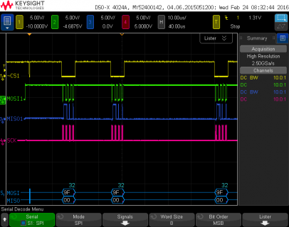

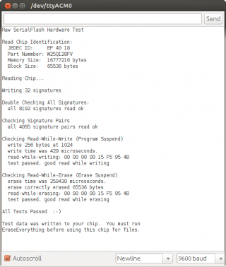

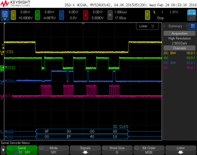

I just ran RawHardwareTest on Teensy-LC with a W25Q128FV. It seems to work fine here. I couldn't reproduce the problem you're seeing.

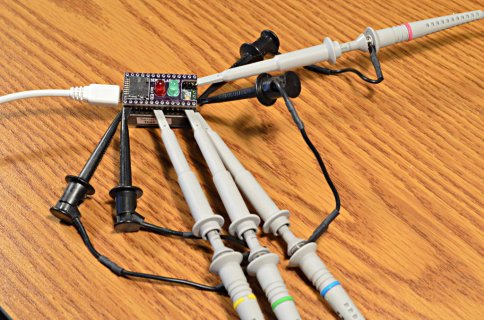

Just to be through, I looked at the waveforms with my scope. Here it is on my desk, so you can see how I tested.
Here's the first 100 us of RawHardwareTest running.
Here's a zoom in to that first SPI transaction where it reads the chip's ID bytes.
(click for full size)
I don't know why it's not working for you.
Honestly, your scope screenshots don't make much sense to me. Looks like a logic analyzer more than a scope... no indication of voltage ranges, no apparent analog noise you'd expect from a normal oscilloscope, and extremely tiny vertical scale.
Anyway, it's absolutely working correctly when I run it here. I'd like to know what the problem is... but at this point all I can say is it's almost certainly something on your end. The library definitely works correctly with this flash chip and Teensy LC.

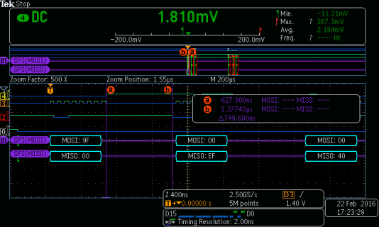

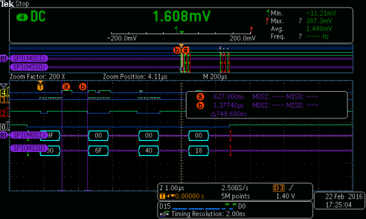

Hopefully these scope screenshots help?
Thanks for your help. I'm working on this for part of a Senior Electrical Engineering project, and can't reasonably move on from this while I still see inconsistencies in reading data.
One possibility is that Winbond updated the silicon on the chip without changing the part number, or that I somehow got a bad lot of chips.
I will keep investigating as I have free time and keep this thread updated.
As to my test hardware, I'm using one of our lab's Tektronix MSO (mixed signal oscilloscope) scopes, which include a sort of logic analyzer capability (the normal scope probes use alligator clips for ground, which was annoying with 4 ground connections to the same point, so I was lazy and switched to the logic analyzer capability because they use a shared ground).
At the very least, it was interesting to see how much overhead there is between the transfer() calls, so I might make a pull request to condense some of those into transfer16() to make a small speed improvement.
I think my next step might be hooking up the analog probes and seeing what the falling MISO signal looks like.
