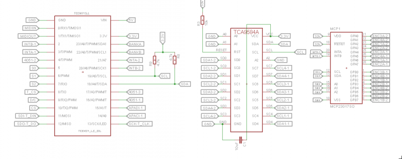

I am really getting hopeless here… The project in a nutsheel:
- 8 rotary encoders via a MCP2307 -> using interrups pins
- 8 SSD1306 OLED screens (with all the same adresses) via TCA9548A I2C mux
The teensy + MCP2307 + TCA9548A are placed on a central “brain” board and the encoder + screens are on “module” board connected to the brain via a ribbon cable. Each encoder has 1 pin connected to the A port and the other pin to the B port. I am using interrupts for both ports. This gives me great performance for the encoders and everything is reading fine.
UNTIL.... I am sending data to the SSD1306 screens, then everything is going wrong. It seems that data coming from the MCP2307 is then no longer accurate and is sometimes corrupted. As in : I am turning a certain encoder but the MCP is telling me that it got an interrupt on another inputs (than the encoder I am turning now). The result is that the code is not registering the pulses from the encoders proprely.
I added a time delay to experiment and tried to send data to the screens ONLY 5/10/15 millisecs AFTER the last MCP2307 interrupt. This helps when rotating the encoder really fast but not when I turn it slowly. Switching between the different screens is easy as sending the right bit to a registers in the TCA9548A. Even when I don’t try to switch between and stick with 1 screen, it doesn’t get better.
So far I tried:
- Different values of pull up resistor on SDA and SCL close to the teensy: 10K, 4.7K, 470ohm. Making no real differences, without any resistors it was not working at all
- Adding pull up resistors to each screen, as specified in the datasheet of the TCA9548 multiplexer : http://www.ti.com/lit/ds/symlink/tca9548a.pdf
- Looking at the SCL signal on the scope, no real difference in the shape of the signal when I start to communicate with the SSD1306 screens
- I tried the standard Wire library as well as the i2c_t3
- I tried different i2c_t3 modes: DMA, interrupts, and the third one
- Different speeds 100hz, 400hz
- I tried shorter jumper wire/cables and it made no difference
- I swapped the Adafruit SSD1306 library for another code but no improvements (http://robotcantalk.blogspot.nl/2015/03/interfacing-arduino-with-ssd1306-driven.html)
I am really stuck here, I am looking to purchase at a logic analyzer to debug the I2C better, but maybe someome has some pointers ? Anybody got experience with relatively cheap SSD1306 screens screwing things up ?
By the way, altough the screens are screwing it up, the MCP23017 encoders code might be interesting.
Thanks in advance!
Nicolas.
As a first step to investigate, I'd try measuring the length of time the SSD1306 takes. Use an elapsedMicros variable, or call micros() before and after.
