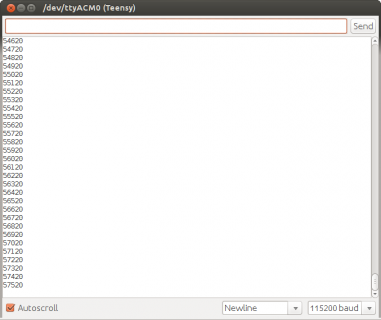

I too am seeing problems with USB. For ages I have had a custom MIDI keyboard working fine, then suddenly today it started acting up and resetting.
So I grabbed my brand new Teensy 3.6 and tried this little sketch:
    Serial.println(millis());
    delay(100);
As output I get:
883
983
1083
1183
1283
1383
1483
1583
1683
1783
1883
1983
2083
2283
2383
2483
2583
2683
2783
2883
2983
3083
And that's all. It stops at that point.
I'm on Linux (Ubuntu Zesty 17.04, but I have also had the same results on Xenial 16.04).
A bit of digging and it looks to be reception without reading crashes nastilly. Seems ModemManager has been reinstalled on my computer with an update (barstewards!). Removing that "fixes" it, but as soon as I send 10 line feeds it crashes. So there is definitely some kind of buffer overrun / lockup issue there.

And are you *sending* data to the teensy? It's the sending without any active reading in the sketch that causes it to crash. Either the Rx buffer is overflowing or its filling up and blocking waiting for the sketch to read from it. If it's blocking then that needs changing. It should be discarding data not blocking. Your choice as to whether it discards the oldest or most recent data to arrive...
