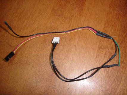

And how do you connect the Dynamixel ?
The Dynamixel should be connected via a 100 Ohm resistor as a protection.
In case that both (Teensy and Dynamixel) send at the same time it protects the output pins.
But this will only happen if there is something wrong in your sketch.
Normally it will never happen that both send at the same time.
Apart from that normally the CPU pins survive shortcuts for a short time.

Hi Frank, I don't wish to be accused of Hijacking again, as I talked about this earlier in this thread.
As I mentioned earlier I have had already success with T3.1/2 talking on the AX-BUS, but again my setup and code were different (using half duplex support of USART, not using his Open drain stuff...). I did notice on some boards if I tried to add a TVS diode to circuit for protection, which dropped the voltage the AX Buss got iffy. Others have had issues, which Elmue said was because they were not using his stuff... Can't say as I have not looked at their code.
However I have started adding some form of buffer to some newer boards I am playing with for a couple of reasons.
1) I may also use a Teensy LC on the board and LC does not handle 5Vs...
2) Serial1.transmitterEnable(s_direction_pin) - I like that using this to switch between RX/TX implies my code does not have to sit in serial1.flush() waiting for the TX to complete, before the code goes off to do something else.
3) Cheap Insurance - If I am building a board that either others may also play with and/or I am adding some other not cheap parts like IMU, then it makes sense to add maybe a $1 with of parts, to make sure that my AX-BUS is up to the vendors specifications...
However for quick and dirty setups, Elmue's code should hopefully work fine. I often start off with a simple setup, for example here is one of my quick and dirty AX servo testing cables and setup:
It has a resistor soldered inline that connects to two wires, plus a ground wire. This type of setup should work with his code, by connecting the two pin connector to pins 0 and 1... Works with my code with just hooking up to pin 1.
So again, sorry if I got a little long winded here and wish him well!
