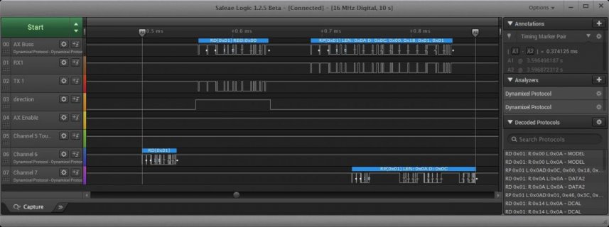

Again I really appreciate all of the stuff you do here and I am aware of availableForWrite (and earlier names), which is great for being able to doing high throughput stuff. What I am interested in doing is more on reducing the latency for when command packets come in and how long it takes to get the response back to the host. Here is an example logic analyzer output for current stuff:
The top line is showing the AX Buss (1mbs). The next two lines is showing the RX and TX pins for the USART going to AX Buss and the direction signal. Currently testing out new board with level shifter IC to convert to 5v... The last two lines are showing the Usart (2mbs) communications to the host, which in this case for testing Odroid C1+. What you can see here is I received the whole request from the host before any data was output on the AX Buss. Now part of this is because the code is setup to receive the first 3 bytes, to see if the command is ours or not. Again I am trying to decide if that is buying anything versus immediately output all data received to AX..

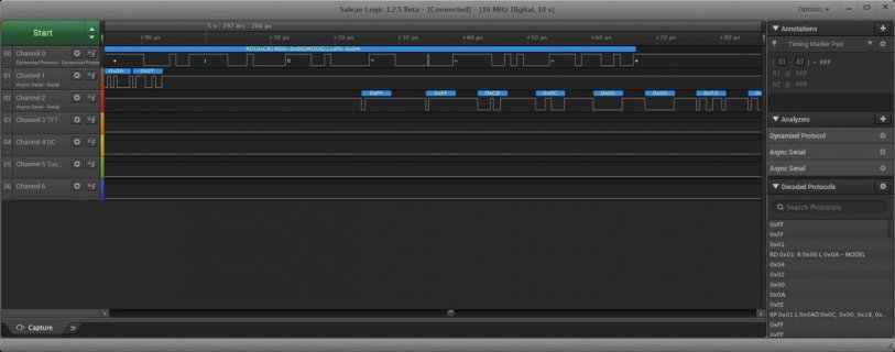

I have also been trying to improve the Arbotix Pro talking to Linux boards. This board has an FTDI chip on it and issues with latency with USB driver where lots of responses would time out at 3 or 5ms... So added code to again talk over TTL Usart. Still debugging it, but I had zero experience with SMT32 programming/debugging... In their code they have the Interrupt handler for the Usarts do the forwarding. Again no experience with these chips, also no bootloader so have to use programmer... I have been trying to improve some of the code, example their Usart code does not make use of the Transmit register empty to output next byte, but waits for transmit complete... But now to the point: With their stuff updated to talk to other usart, I see:
In this one you can see again top line is AX, host is repeated twice (checking level shifter), but you can see that there is about a 1 byte difference from seeing bytes from host go out on AX...

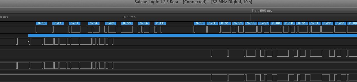

Again sort of off topic, but again showing issue that they were not double buffering on Arbotix-Pro...
You can see gaps between bytes even though there were ones available...
