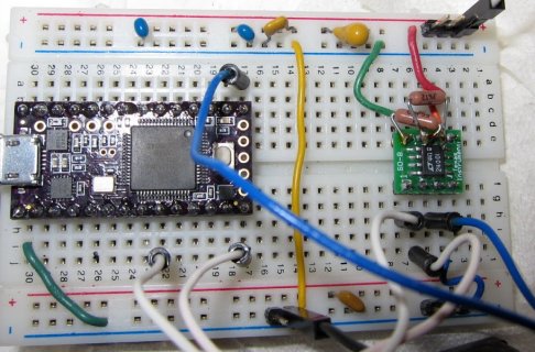

In case of interest. The Linear Tech LTC2400 is the easiest to use 24-bit ADC I've found (in a SO-8 package, not much to go wrong).
Using 4x NiMH AA cells to provide a quiet +5V supply, with 2x 1.000k 0.1% resistors as a 2:1 divider to put the input at 0.5 Vref, and running the above code I see the output readings have about 1.7 microvolts RMS noise, that is less than 0.5 ppm of the 5V full scale. Not bad at all, and I didn't even separate Vref from Vcc. Note: if I use the +5V USB for Vref instead of the battery supply, I get about 100 uV rms noise.
I soldered the 2x1k input divider to the board, because you can't get microvolt low noise connections using breadboard contacts.
Interface Teensy 3 with Linear Tech LTC2400 24-bit ADC (7.5 Hz sample rate)
by J.Beale March 26, 2016
Signal ADC Teensy
CS: pin 5 pin 7
MISO: pin 6 pin 12
SCK: pin 7 pin 13
