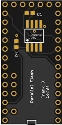

some of you may have noticed, that i added an SPI Flash with 4-BIT parallel connection to an other project.
Maybe it is useful for other projects, too. I have uploaded the library to https://github.com/FrankBoesing/ParallelFlash, along with eagle schematics and board (you can upload the .brd-file to OSH-park or digistump).
It is highly experimental, but so far i have'nt had any problems with it.
The board is totally untested (but it is so simple that it should work :) ), i tested the library in my other project, with an W25Q128FV only.
I measured transfer-speeds (for reading) of more than 5 Megabytes / Seconds.
"TeensyTransfer" is compatible, just enable "_HAVE_PARFLASH" in the *.h file.

Frank, I have an adafruit winbond W25Q80BV 1 MB (DIP) that I've used with Paul's SerialFlash, so I thought I'd give your library a try...
I got the latest ParallelFlash from github, and got a compiler error, n undefined in ParallelFlashChip::capacity() ?? So I commented out the n=0;, still a warning
libraries/ParallelFlash/ParallelFlashChip.cpp:656:1: warning: control reaches end of non-void function [-Wreturn-type]
but i can live with that.
I ran the ListFiles example (I had just run SerialFlash to verify it had files and such), but all i got was
All Files on Flash chip:
Status Register 1:0x2
Status Register 3:0x0
Status Register 2:0x0
I re-checked my breadboard wiring based on your pin table on github. still no workee. I tried a readID() and got FF's ...
any thoughts? wires too long for high data rates?
(i'll check my wiring again) I'm using teensy 3.2 @120 mhz (tried at 72mhz) with IDE 1.6.7
EDIT: I hooked CLK, d0, d2, (and pin 13 for start/stop) to analyzer around a ParallelFlash.read() of 256 bytes at CPU of 72mhz (analyzer max is 50mhz). I see lots of activity on CLK, but not a steady CLK stream, pauses , max short burst 12.5mhz?. Only a few spikes on d0, and no spikes on d2, of course it says it read all 0's. (actual block start was byte 32768 which should have non-zero file data).
@120mhz, the 256-byte read takes 48 us (= 42.7 mbs), for comparison, the SerialFlash SPI rate was 11.9mbs
(I hooked flash back up as SPI to confirm file data was still OK. it was OK)
God, I need holidays... yes, the last edit to capacity I made was errornous.
I did not test the library with other Chips than the W25Q128.
Tomorrow, I'll read the Datasheet of W25Q80BV. Maybe this chips want a bit different handling ?
But I don't have a W25q80, so i can not test it.
I just took a quick look. Seems Windbond updated a lot since W25Q80.
- it does not have status register #3 (this is not really needed, so: not important)
- More important, the Datasheet does not mention the QPI-Mode - and command 38h is missing.
Maybe we have to use quad-spi instead (thats a different mode. QPI is faster....)
More tomorrow (its after midnight here).
Thanks. no QPI explains it.
probably not worth worrying about older product line. (adafruit no longer stocks the DIP)
