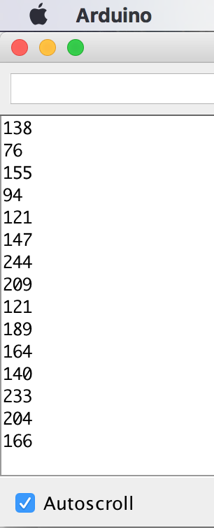

These are the numbers that are shown to me when turning on the serial monitor:
it just keeps writing numbers over and over and it doesn't stop.

@FelixButt ... those numbers are supposed to repeat continuously ... they look almost like there is nothing attached to the pin!! not what you would expect with a pot attached at all ... check your wiring ... there is like over 100 difference between low and high ... that is a lot of noise.

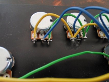

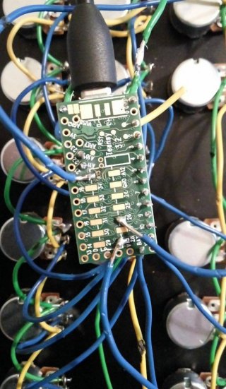

Guys, i have not figured out how to make this controller work yet. I think its the best idea if i explain in detail how i build it and maybe you more experienced guys can tell me if there is any fundamental mistake i made:
First of all, i screwed the 10k linear pots onto an eloxated aluminum plate and wired everything together like so:
The green wire is for my ground, the yellow wire is my power supply, and the blue wires are my "signals" that are connected to the analog input pins on the teensy.
The yellow wire was originally soldered to the 3,3V pin, but that had the same problem with jumping CC Values, so i switched the VIN pin (which is wrong from what I've heard) and still my CC Values are jumping.
The green wire is attached to the GND pin right besides the micro usb input. Is it maybe that i have to switch the green and yellow wires connections, that the green wire goes to the 3,3V pin and the yellow to GND ?
There are 3 blue wires soldered onto the pads on the bottom (A13, 28,26), whereas the other wires are just soldered to the side of the board. no soldering on the board is touching another wire or anything, it all looks pretty clean.
As live mentioned before, i used the code that recommended on the PJRC website and only changed the number of analog inputs. Again: The analog inputs are not really in the right order, but i don't know if thats a problem.
the pins i used are actually not a A0-A15, but A0, A1 , A2, A3, A4, A5, A6, A7, A8, A9, A10, A11, A13, A14, A15, A17
Guys, sorry for taking your time. i figured it out. the problem will make you laugh: i accidentally soldered the wires to the digital pins on the other side of the board and not the analog inputs.
I guess the next time i solder, i'll make sure im rested enough. Lol.
Yikes - that is even shown in your picture! Adrian and I wondered about your INDEX values swapping the read source - but didn't look at your soldering. And the board is labeled on the bottom too - that's okay my test sketch above hacked from your code was messed up too as written.
ooooh. Hopefully you are getting somewhere ... you will need to change your sketch if you have not wired numerically 'straight through' ... use a pin table array as your index!
