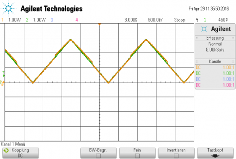

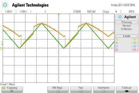

When I try to read the voltage of a relatively high impedance source, I see jumps in the readings of the analog pin around midscale. Looking at the voltage on the pin, the jumps are visible, too. In my setup to look into this, I connected a signal generator over a resistor (first 10k, then 100k) to the chosen analog input. I monitored the signal of the generator and directly at the analog pin of the Teensy with an oscilloscope. With 10k the jumps in the signal are quite regularly and the . With 100k there seems to be some kind of "pull-up" because the signal on the pin is higher than the signal coming from the generator. I know that it would be better to use lower impedance sources, but anyways I would like to know, where this strange behaviour comes from.
Here is a minimal code example and two pictures of the oscilloscope.

10k series resistance:
100k series resistance:
Looking at your scope traces, I shall assume that the green trace is the output of your signal generator and the yellow trace is on the input of the Teensy. Looking at the lower photo with the 100K resistor, when your input gets to about 1.5v it appears there is some extra current coming from the Teensy causing the voltage at that point to rise as it is causing the voltage drop across the resistor to become greater. As the signal voltage approaches 3v the current from the Teensy become less and corrupts the measured value less too. As the signal approaches 0v it appears the cause of the extra current gets shut off again until the signal rises to 1.5v and the cycle starts over. I don't know if anyone on this forum has intimate circuit knowledge of the inputs on the Teensy and what the root cause of this leakage is, but it appears it is caused by the Teensy. Based on the differences in voltages and the values of the resistors I calculate the current to be from 0 to 15microAmps (uA). Using Ohms law E=I*R we can see that 100K Ohms at 10uA causes a 1v drop, while at 10K Ohms the same 10uA current causes 0.1v drop which could explain the differences in the voltages you are observing.

I wasn't aware that selecting pinMode(xx, INPUT) is only for digital usage. Deleting this line from the sketch did the trick :)

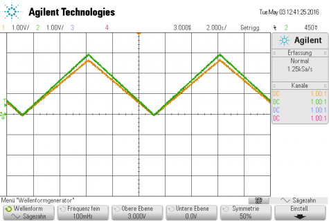

Just in case someone is interested, here is the display of the oscilloscope after deleting the pinMode-line. And yes, green is the signal generator, yellow is the Teensy-pin.
With 10k resistor in series:
With 100k resistor in series
