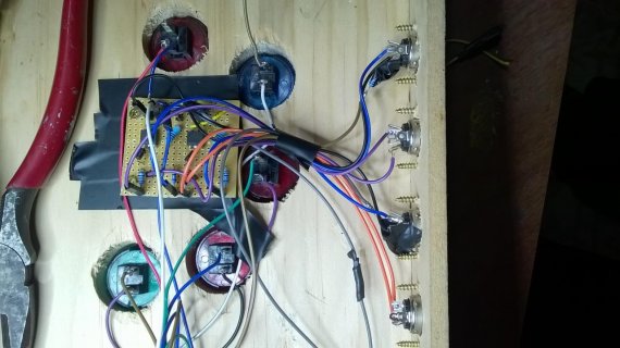

Meanwhile here is a picture of my 2 x 2 midi merge / split interface, and the code (not for sysex and realtime etc) ... I haven't turned off "through" in the serial midi library, and I actually don't have enough bits of midi gear and cables to test all 3 ports running simultaneously!! :eek: I think I will have to buy some extra cables to do loops.... (the code needs the library tweak to work)
sysex etc should be easy but not right now ...
#include <MIDI.h> //MIDI 4.2
MIDI_CREATE_INSTANCE (HardwareSerial, Serial1, midiA);
MIDI_CREATE_INSTANCE (HardwareSerial, Serial2, midiB);
  midiA.begin();
  midiB.begin();
  if (usbMIDI.read()) {
    midi::MidiType TypeUSB = (midi::MidiType) usbMIDI.getType();
    byte dUSB1 = usbMIDI.getData1();
    byte  dUSB2 = usbMIDI.getData2();
    byte ChanUSB = usbMIDI.getChannel();
    midiA.send(TypeUSB, dUSB1, dUSB2, ChanUSB);
    midiB.send(TypeUSB, dUSB1, dUSB2, ChanUSB);
  if (midiA.read()) {
    midi::MidiType TypeSerial1 = midiA.getType();
    uint32_t dmidiA1 = midiA.getData1();
    uint32_t  dmidiA2 = midiA.getData2();
    uint32_t ChanA = midiA.getChannel();
    midiB.send(TypeSerial1, dmidiA1, dmidiA2, ChanA);
    usb_midi_write_packed((uint32_t) TypeSerial1 >> 4 | (uint32_t) TypeSerial1 << 8 | (((ChanA - 1) & 0x0F) << 8)
                          | ((dmidiA1 & 0x7F) << 16) | ((dmidiA2 & 0x7F) << 24));
  if (midiB.read()) {
    midi::MidiType TypeSerial2 = midiB.getType();
    uint32_t dmidiB1 = midiB.getData1();
    uint32_t  dmidiB2 = midiB.getData2();
    uint32_t ChanB = midiB.getChannel();
    midiA.send(TypeSerial2, dmidiB1, dmidiB2, ChanB);
    usb_midi_write_packed((uint32_t) TypeSerial2 >> 4 | (uint32_t) TypeSerial2 << 8 | (((ChanB - 1) & 0x0F) << 8)
                          | ((dmidiB1 & 0x7F) << 16) | ((dmidiB2 & 0x7F) << 24));
I've been goofing off playing amazing grace on my laptop keyboard, out over midiox via usb to teensy, and then over serial to my serial only midi rack synth. mucho fun.
edit: haven't worried about running status at this stage ... USB midi doesn't use running status anyway, but I'm not sure how it plays out on the serial split merge side of things ... maybe it just works? Seems to so far, but I haven't done a proper merge test yet (not enough gear)
