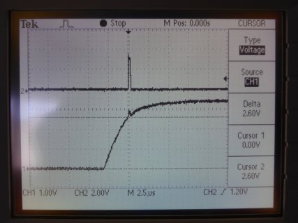

Thanks for all for the suggestings. I added some code to one of the interrupts to trigger a scope to investigate:
void ncdr_R2Int(){
    int r=vrencodercnt;
    //delayMicroseconds(5);
    digitalWrite(AVAILABLEPIN, HIGH); //mdr20160620 test
    digitalWrite(AVAILABLEPIN, LOW);
    r+=digitalRead(NCDR_R1)==digitalRead(NCDR_R2) ? 1 : -1;
    vrencodercnt=r;
Upper trace is the trigger (AVAILABLEPIN), lower is the Hall sensor interrupt. So the voltage is at least 2.6V which should be ok. Adding delay didn't help. The falling edge, not shown, is very steep. Changing the interrupt priority didn't help but may when I enable some of the other stuff. The count did seem to get messed up worse with higher motor accelerations and speed, even though the traces I captured looked the same.
The problem turned out to be messy wiring on my prototype setup. Twisting the digital power, gnd and two hall wires together and separately twisting the motor wires together solved the problem. Duh The final version will also have shielded wires.
