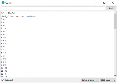

Another thing that someone helpful suggested was to dump the registers. If you can get good register values, for example an 0x24 from Register 0x10, you can be confident that your main SPI connection is good - CLK, MOSI, MISO, CS. You can't get register values if any of these is unhappy. I did it in bool RH_RF69::init() right before the setIdleMode() call - because in my case that was where execution was hanging.
Thanks, Davidthings. I have not tried printRegisters since updating the library. I'll try again. Hopefully it is included in the new library and I use the proper syntax.
(Any hints on syntax would be appreciated since this level of detail is new for me.)
In the init function, before the setModeIdle() (approximately line 150) just call:
  printRegisters();
At startup you'll get a column of numbers.
I get:
0 0
1 4
2 0
3 1A
4 B
Got it - thank you for the detail!

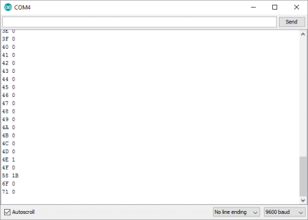

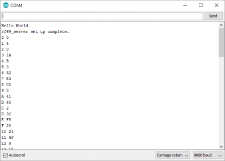

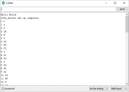

I conducted four different trials today and still am not receiving a message. My conclusion thus far is that the printRegisters is operating as intended and that both resets from iwanders and davidthings have the same result.
Here's a description of my four attempts. I've also attached associated code (but was unable to attach RH_RF69.h).
First Attempt:
  • Downloaded the most recent RadioHead library files from www.airspace.com/mikem/aduino/RadioHead
  • Removed the RadioHead library files from c:\Program Files (x86)\Arduino\hardware\teensy\avr\libraries\RadioHead
  • Installed the new RadioHead library files to the same same location.
  • Modified RH_RF69.cpp to add printRegisters(); just above the setModeIdle(); around line 150
  • Modified rf69server and rf69client in the Examples
  • Added hardware resets per davidthings, first thing in setup()
// Perform a hardware reset per davidthings.  The reset pin on the RFM69HCW is set to Teensy 3.2 digital pin 6
pinMode(6, OUTPUT);
digitalWrite(6, HIGH);  //RESET
delay( 100);
digitalWrite(6, LOW); // ~RESET
delay(100);
// end of reset;
  • Directly after Serial.begin(9600); added
// Previously added delay may be unnecessary now:
 while (!Serial && (millis() <= 8000));
  Serial.println("Hello World");
  Serial.println("rf69_server set up complete.");
  // End of my addition
  • Modified if (!rf69.setFrequency(433.0)) to use 915.0 instead of 433.0
  • Uncommented line rf69.setTxPower(14);
  • (Server and client mods are the same except the print statements regarding set up complete.
The output from this attempt is shown below:
Although not shown, the server did not receive or acknowledge the message from the client.

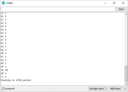

Second Attempt:
  • Commented line RH_RF69 rf69;
  • Uncommented line RH_RF69 rf69(15, 16); because I wasn't sure if this referred to any Teensy-compatible breakout board or PJRC's proprietary one.
Result:
  • Same output on server, then a solid LED
  • Significantly different output on the client. No register data was printed and I received an 'init failed' message.
Third Attempt:
  • Kept the same RH_RF69 rf(15, 16);
  • Reverted back to iwanders reset on both server and client
  pinMode(6, OUTPUT);
  delayMicroseconds(150);
  pinMode(6, INPUT); // ~RESET
  delay(100);
  // end of reset;
Result:
  • Same as second attempt.
Fourth Attempt:
  • Revert back to the original RH_RF69 rf69;
  • Keep the iwanders reset from the third attempt
Result:
  • Same as attempt #1
  • Solid LED is gone
server_output1_attempt4.pngserver_output2_attempt4.pngclient_output1_attempt4.pngclient_output2_attempt4.png

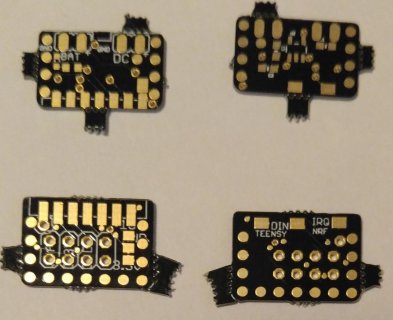

@iwanders - I ordered your board from https://pcbs.io/search (that link goes to the shared boards page)
I should be getting a set in a week or two. Cost was $1.25+$1.40 for what will be 4 (perhaps 6) units of the two parts. With your permission I could mark the board for display on the SHARED page linked above and anyone could order from there - as it is done on OSH. If you ever order from there you could share it or other boards. There is a percentage of board cost accumulated as a reward each time a shared board is ordered.
For instance FrankB shared this: https://PCBs.io/share/46718
Could wait to be sure it works - the other boards I've gotten from there seem to be good.

My copies of the iwanders two part mount boards showed up today. $2.65 and I got 5 copies of each.
BUMMER <edit> - it's confirmed the FAB missed holes on many boards all over a whole panel.
PROBLEM:: I just noticed the pads are not drilled through!!!!!
<edit> :: Looking at the images on the order the drill holes look to have been right - I sent email - for confirmation - may have just missed a processing step.
