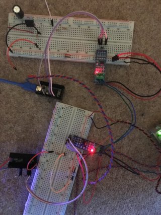

So I have decided to connect my Teensys together with RS-485. I have made a start but not all is working smoothly.
The stuff I have read up on are:
RS 485 Wiring
Connections and circuitry needed
What the whole circuit should look like
Info about the RS85 transceiver
Teensy pins to use
I think I have the circuit set up correctly
See image:
(Ignore the loose wires on the left hand side of the top board)
Power (+ and -) is going from the Meanwell LRS-350-5(5V,60A) to 4 places.
1 - to the Master Teensy
2 - to the Slave Teensy
3 - to the top breadboard rail
4 - to the bottom breadboard rail
The top breadboard has the master Teensy(with the blue USB cable going into it/out) connected to the receiver
The transceiver has wires going to these pins on both of the Teensys (same for Master & Slave).
DI - Teensy pin 9
DE - Teensy pin 5
RE - connected to DE
RO - Teensy pin 10
The slave Teensy is the bottom one.
The transceivers are connected from A to A, and from B to B
Regarding the connections and wiring, does this all seem correct? Is there anything that needs changing?
I have not used any resistors because I think the transceivers already have 120R included so there is no need to attach further resistors, that is correct?

All in all, I think the wiring is fine, but I am struggling with the code now
What do I need to do to make the Master tell the slave to operate blink for 1s intervals. I will expand upon that, but I feel this is a good start point.
I am decent with coding, but I have never communicated with another device before so this is new territory for me

and finally, the current circuit layout did not work for me. I assume it is the circuit and not the code because when I swapped back to TX/RX Teensy to Teensy lines it worked fine. Should the wire which is attached to DE/RE be connected to some other pin on the Teensy rather than V++(for master) & V--(for slave)? That doesn't quite seem right to me (and my novice mind)?
both Teensies (+RS-485 modules) are powered on?
I'll try to rebuild the circuit later, but the circuit should work.
... maybe upload a picture from the circuit

Both Teensies are powered
sorry about the massive pic, not sure how to trim it down.
Top one is the Master
Bottom one is the slave
Potentiometer is on the top left, connnected to power rail and Teensy pin 14 (Pot works fine)
On the master and slave RS485 transceiver it is Purple wire from DI, Grey from DE.RE and White from RO.
White to pin 0, Purple to pin 1 and Grey to V++ power rail for Master and V-- for Slave
LED pins, 10,11,12
Transceiver, Vcc to V++ rail, GND to V--rail. A to A and B to B
the wiring looks good.
why is the led on the Teensy on? It's not used in the code.
One led pin 10, 11 or 12 is on, they shouldn't light up without data over RS 485.
The red wire from the Potentiometer goes to the 3.3V pin (and not VIN). But this isn't the problem.
Are the usb cables plugged in a computer? If so:
- remove all wires to the the Meanwell power supply
- disconnect both usb cables
- connect both usb cables
- open serial monitor for the slave
I've set it up here, it works with the code from post #7 and wiring from post #9. I don't have the same RS 485 modules. Both RS 485 Transceivers are similar to the one on your modules. A picture won't help much, but maybe you can see something: (I don't have a potentiometer, I use a floating wire): https://dl.dropboxusercontent.com/u/2486346/pjrc/rs 485.pdf

Not really sure why the light was on for the Teensy, after re-wiring all the wires but it is no longer turned on.
Followed the steps you said and my conclusion is that there seems to be an error with sending the signal from the Master to Slave.
The reason I've come to this conclusion is that when I open the Serial Monitor for Master it says "Sensor Value Equals: xxxx" However when I open the slave it does not say "Receive Sensor Value: xxxx". It is just blank with nothing on the Serial Monitor.
I'm just going to play around/change the wires to see if something is maybe wrong with the wires here?
Changed all the wires and the transceivers with no change...bit stumped now...
maybe, the tiny jumper wires for DE/RE don't make a reliable connection.
If you have a voltmeter you can check the DE and RE pins. With an oscilloscope you could check RS 485 A and B.
I got it working.
I changed everything, so the two Teensy's, the two transceivers and made sure all the wires were working....the problem....one of the transceivers was not working properly.
So annoying when it is such a little thing...
One other thing though, my master transceiver is hot to touch? Should this be the case/of concern?
quite happy now :) :) :)

wiring
the wiring is similar as before, connect RS 485 A and B. Another topic is whether the RS485 bus needs a common ground connection or not. Texas Instrument writes:
Grounding and Shielding
Although the potential difference between the data-pair conductors determines the signal without officially
involving ground, the bus needs a ground wire to provide a return path for induced common-mode noise
and currents, such as the receivers' input current. A typical mistake is to connect two nodes with only two
wires. If you do this, the system may radiate high levels of EMI, because the common-mode return current
finds its way back to the source, regardless of where the loop takes it. An intentional ground provides a
low-impedance path in a known location, thus reducing emissions.
Electromagnetic-compatibility and application requirements determine whether you need a shield. A shield
both prevents the coupling of external noise to the bus and limits emissions from the bus. Generally, a
shield connects to a solid ground (normally, the metal frame around the system or subsystem) with a low
impedance at one end and a series RC network at the other. This arrangement prevents the flow of DC
ground-loop currents in the shield.
AN-1057 Ten Ways to Bulletproof RS-485 Interfaces http://www.ti.com/lit/an/snla049b/snla049b.pdf
Another good read is: The RS-485 Design Guide http://www.ti.com/lit/an/slla272b/slla272b.pdf
Hey HWGuy
got it all sorted first go, thank you ever so much for that!
thanks for the reads too.
