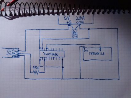

I know I posted this in another thread but I think this belongs here and I'd like to clear a few things up. TLDR = the "AudioConnection" line of code screws with my LED strip. Any help is very very much appreciated!
All I'm using is a Teensy 3.2, a 300 LED WS2812b strip, and the audio adapter. I only want the audio adapter to take inputs from either the Mic or Line In, and do FFT. Currently, I have the LED strip working perfectly when I'm not using the audio adapter, and the audio adapter working perfectly when I'm not using the LED strip. :( As you can imagine, I'd like to have them working together and I know a ton of other people have done this, which is quite frustrating to be honest.
WIRING
The audio adapter isn't stacked on the Teensy, but I have these wires connected (through a breadboard) since I only need Line In, Mic, and FFT working: 3.3V, LRCLK, SDA, SCL, RX, MCLK, BCLK, GND.
This is my wiring of an SN74HCT245N chip except I do not have a capacitor across the 5V and COM pins. LINK TO CHIP ON DIGI-KEY

BONUS CODE: I Tried the FFT tutorial example and the same thing happens. The problem seems to be the "AudioConnection" line of code. When it is commented out, the LED strip shows a rainbow. When it is not commented out, the first 50 or so LEDs in the strip flicker a bright white with the rest of the strip showing a rainbow.

EDIT: It turns out that the problem is most likely the WS2812 strip, where an APA 102 would work instead.
EDIT 2: Fixed it! I implemented the OctoWS2811 library and the parallel output functionality of FastLED 3.1.
