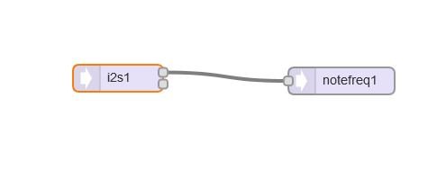

Next step:
Design of note frequency detection via mic.

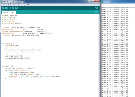

#include <SerialFlash.h>
AudioInputI2S            i2s1;           //xy=246,135
AudioAnalyzeNoteFrequency notefreq1;      //xy=623,182
AudioConnection          patchCord1(i2s1, 0, notefreq1, 0);
    AudioMemory(30);
     *  Initialize the yin algorithm's absolute
     *  threshold, this is good number.
    notefreq1.begin(.15);
   // pinMode(LED_BUILTIN, OUTPUT);
    // read back fundamental frequency
    if (notefreq1.available()) {
        float note = notefreq1.read();
        float prob = notefreq1.probability();
        Serial.printf("Note: %3.2f | Probability: %.2f\n", note, prob);
At that point serial monitor gives me ca. 83Hz…

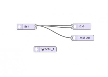

To understand the problem better I connect also the output (to stereo) to hear what happens.
AudioInputI2S            i2s1;           //xy=352,135
AudioAnalyzeNoteFrequency notefreq1;      //xy=600,228
AudioOutputI2S           i2s2;           //xy=626,144
AudioConnection          patchCord2(i2s1, 0, i2s2, 0);
AudioConnection          patchCord3(i2s1, 0, i2s2, 1);
AudioControlSGTL5000     sgtl5000_1;     //xy=525,305
   AudioMemory(30);
  sgtl5000_1.enable();
  sgtl5000_1.volume(0.6);
  sgtl5000_1.micGain(30);
    //pinMode(LED_BUILTIN, OUTPUT);
Now I heard that noise which gets a little bit louder every time it prints out a new line to serial monitor. If I halve the CPU to 24Mhz the frequency duplicates to ca. 170Hz.

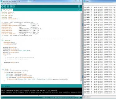

First run at 96 MHz or higher. Second check the cpu usage. I think the way the library is configured it will use to much cpu for this to work. Let me know what the cpu usage is at 96MHz or higher. I wrote this library.
Hi duff,
many thanks for your prompt reply.
That’s great!.. it works with 96Mhz. :)
Also my voice now sounds clear and not anymore brazen.

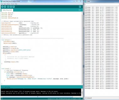

For cpu and processor usage I found this library:
https://www.pjrc.com/teensy/td_libs_AudioProcessorUsage.html
I have inserted it in my code:
   AudioMemory(30);
  sgtl5000_1.micGain(15);
       int cpuusage = AudioProcessorUsageMax();
        Serial.printf("CPUusage: %i | Note: %3.2f | Probability: %.2f\n", cpuusage, note, prob);
Yes CPU usage seems to be high, if I have implemented it in right way.
CPU usage of 92% at 96Mhz.
Doubles to 180% at 48Mhz.
