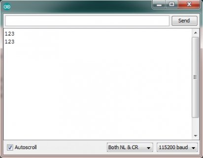

The picture shown below shows the scope display after typing the three characters "123" followed by the RETURN Key, and I have annotated each individual bit so that other users can better understand how the data should actually physically appear on the output pin 1 (TX1) when using RS232 serial encoded data. I also include a picture of what appeared on the ARDUINO IDE SERIAL MONITOR after typing.
You can see in the second picture that the display of "123" is repeated twice. This is because I have wired the two pins 0 and 1 (RX1 and TX1) together and my code is also showing the incoming bytes as well as the outgoing bytes. Looping the RX1 and TX1 pins together is a good simple way to test the output. If the incoming bytes are not identical to the outgoing ones, then something is not correct.
