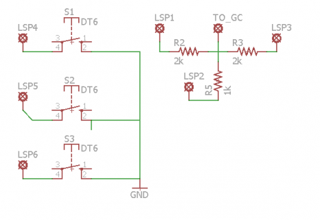

Basically, I want to replace a 2 potentiometer joystick with 8 digital arcade buttons (4 cardinal directions, and 4 modifier buttons).
Here is how each potentiometer system would work:
- There are 4 buttons per potentiometer: one triggers full low, one triggers full high, and two are modifiers.
- The modifiers scale the output triggered by the low or high buttons to a configurable percentage from the middle (each modifier has its own percentage).
- The output to the potentiometer goes to the middle value when no buttons are pressed.
- If a either a low or high button is pressed after the other has been held down, the newer button press takes precedence.

The Atiny84 can do that, but I've found them tricky to get working and a nightmare to debug and unless you are pretty good at working in a very basic CPU would suggest not using them. Note that the sparkfun digital pots do not come with example code, though there is something linked in the comments, before ordering suggest looking at that and making sure it at least still compiles.
To measure the hardware grab a multimeter and check what range of resistances you get from ground to control pin.

It's your project, but would suggest that the Nicohood library plus:
http://playground.arduino.cc/Code/Keypad
Running on a uno or clone would be the easiest way to get something you can get out and rumble with.
Looking at https://github.com/NicoHood/Nintendo/blob/master/src/Gamecube_N64.c I can see why it's locked to 16mhz and Atmega since it's doing NOPs to get mark/space right so not easy to make it portable to any other CPU or speed, sorry for sending you down that path since had assumed it would be using 'delay()'.
With that out of the way would still suggest a good starting point is building a hard wired D-pad. Gives you a chance to try buttons and physical build (shop around for buttons since some are pretty rubbish).
Idea is to change the pot https://en.wikipedia.org/wiki/Potentiometer
to a restive divider https://en.wikipedia.org/wiki/Voltage_divider#Resistive_divider_2
with four elements in it, two of which can be shorted by buttons (and whole setup duplicated for the other axis)
+v for original axis--R1=300ohms----r2=2.5k-----r3=2.5k----r4=300ohm--gnd

I'm not quite clear on what the circuit is trying to do, other than being a nice demo for inductive resonance. A workable solution without NC switches but using a micro controller is:
Idea is that rather than using the power and ground connections on the PCB we use pins that are either on, or disabled rather than the normal on/off states.
There are a lot of different ways to do this using variably complex code and numbers of pins but this was the first that I came up with.
R5 and micro controller pin LSP2 is there to provide the modifiers and is normally left disabled and not impacting the circuit.
So conditions are:
No buttons pressed - LSP1 output - high and LSP3 output LOW -LSP2 input/highz- to_GC is half way between them
direction 1 button pressed - LSP1 Input/high z - LSP3 output LOW - to_GC is pulled low
direction 2 button pressed - LSP1 output HIGH - LSP3 input/high z - to_GC is pulled high
direction 1 button pressed+mode - LSP1 output - high and LSP3 output LOW - LSP2 pulled low - to_GC is pulled lower than mid range but not all the way
direction 2 button pressed+mode - LSP1 output - high and LSP3 output LOW - LSP2 pulled high - to_GC is pulled higher than mid range but not all the way to +ve
Key thing is that the micro controller output voltages MUST be the same as the ones applied to the pots so first step is to confirm they really are 3.3v.

I'm afraid your suggestion might be going over my head. I'm not entirely sure what LSP means. Are those digital i/o pins on the Teensy?
This is how I am interpreting what you are saying:
- Run my buttons like the left part of your picture shows to separate digital pins.
- Process with microcontroller code.
- Use different digital out pins in series with resistors connected to where the wiper inputs for each axis on the GC controller.
Is this what you are saying? Sorry if these are novice questions, trying my best to keep up!
That's pretty much what I was looking at. Key trick is that pins can be used as more than basic inputs or outputs. By wiring as above you can manipulate the three control pins to be either high, low or not allowing any current (high z, where z is impedance which is a fancy word for resistance), giving a range of options.
Your circuit will work with a bit of tweaking, but uses the modifiers different to how I thought you had intended. Was the plan that the modifer was like a shift key that you held while pressing another button, or is the plan to have two mod buttons per axis, where you press either 'full force up' or 'half(ish) force' up?
