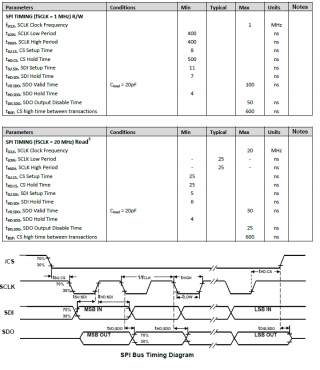

I'm finally getting back to a Teensy-based datalogger project of mine. Among other sensors, one I am using is the ITG-3701 from Invensense. Here is the datasheet and here is the register map.
My confusion stems from the SPI Mode. I've included a few snippets from the datasheet below:
And from page 19 of the datasheet:
SPI Operational Features
1. Data is delivered MSB first and LSB last
2. Data is latched on rising edge of SCLK
3. Data should be transitioned on the falling edge of SCLK
4. SCLK frequency is 1MHz max for SPI in full read/write capability mode. When the SPI frequency
is set to 20MHz, its operation is limited to reading sensor registers only.
From the image, I take it to mean that CPOL=1 as it looks like it wants the clock to idle high. And from the text quoted above, it looks like CPHA=1. So, SPI mode = 3. Except no, only SPI mode = 0 reads back a non-zero value for the who_am_I register, for example (and on mode 0 it returns 0x68 as expected. With SPI mode = 0, I then derrived the below code, which plots nicely on the serial plotter (my first time using it!), and gives fairly reasonable results as I rotate the board along the various axes.

So what am I missing? Surely SPI modes aren't different on Teensy, are they?

I guess I wasn't quite clear enough. I did just this, anything but SPI Mode 0 returns 0x00. Mode 0 returns 0x68, which is correct according to the datasheet.
My question is WHY, when the documentation suggests to me that it ought to be a Mode 3 device. Perhaps I have mis-interpreted the datasheet and/or the SPI mode table?
I misread/misunderstood your post. I agree that the datasheet indicates that the clock idles HIGH and so the mode should be 2 or 3. The manual for the K66 also indicates that CPOL=1 when the clock idles HIGH so it's almost certain to be the same for the T3.2 processor.
But it works with mode 0. Go for it :)
Pete
