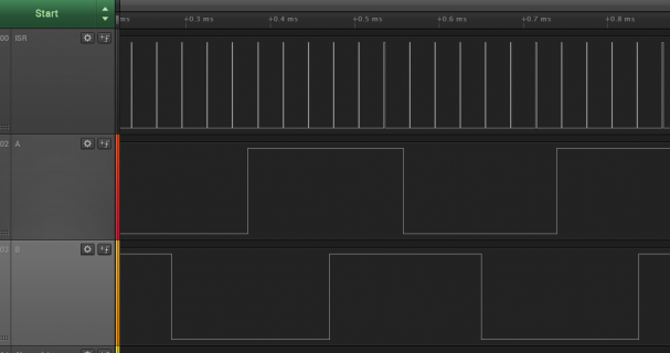

    here my code. Opposed to the standard encoder library I don't use port interrupts for counting the quadrature signals but a fixed sampling frequency.
    Reason:
    My main application is to read out high resolution encoders on my lathe. If the machine stops "near an encoder edge" vibrations can generate a high frequency up/down counting signal which would lead to a very high number of interrupts. Using a fixed sampling frequency is said to be more robust in these situations. Algorithm and discussion (german) can be found here https://www.mikrocontroller.net/articles/Drehgeber

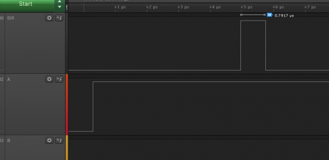

    In case you want to try it, I extracted my encoder code into a library and did a small example with 6 encoders (attached). Just out of curiosity I tested the performance with a T3.6 @240Mhz. I connected an encoder (Heidenhain ROD426-1000) and tried to rotate it by hand to get about 10kHz pulse frequency which roughly corresponds to your 130rpm / 4096 counts/rev. Sampling frequency was 33kHz.
    The pictures show the A/B signal (trace 2/3) and the time spent in the interrupt (trace 1).

    Result:
    • reading out 6 encoders requires a total time of about 0.8Ás. At 30 kHz sampling rate this corresponds to a processor load of 2.4%.
    • 6 encoders with a required count rate of 200kHz would need a sampling frequency of at least 400kHz. This would lead to a processor load of about 30%
    Would be interesting to compare to performance data of the standard encoder lib.

    I was wondering: how did you measure or estimate the 0.8Ás time required to sample the encoder signals?

    I just set a pin to HIGH when I enter the ISR and back to LOW when I leave it. For the actual measurement I use a cheap logic analyzer (traces shown in the post). This of course does not measure the time required for e.g. pushing/popping registers and it does not take into account that the optimizer might shuffle the execution order (pin might be set HIGH some time after the code enters the ISR). But for that kind of performance estimations it should be accurate enough.
