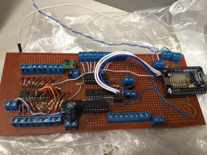

Solved
Just thought I'd update that an 11V Zenor diode and 100k resistor did the job with mcp23017 inputs.
Ignore that esp8266. It's getting replaced with a teensy and wiz5100 i swear.
