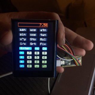

Oh, I'm not giving up. What I'm doing is rewriting an old screen management/windowing/event/drawing structure to run with new hardware. In the past it's been just bent, hammered and tweaked to run whatever was going on at the time. I'm setting it up so you can drop in new screen hardware and it "just works" sort of. If there's any old Mac developers out there reading this, think powerPlant from Code Warrior for Arduino. The original version of this actually ran on an UNO. But, it limited what you could do seeing as it was pretty big. I was able to create a nifty little RPN calculator on an UNO with an Adafruit Cap touch screen. The full version runs on my Mac. But couldn't quite fit all the buttons into RAM. When I bought the Teensy for the eye project, I realized "Hey! I could fit my calculator into this!" So the rewrite started.
So that's where I'm coming from. The SPI supercharging idea was a side track to the huge nonsense I'm working on. Sadly, now I've allowed myself to write for the teensy, I doubt I'll ever get this to fit on an UNO again. :(
-jim lee
Success!
I can't draw fast like the cool kids, but I do now have the beginnings of a tiny OS that runs in the background of your sketches. So if you want your sketch to have a little more pizzaz, this is the ticket!
-jim lee
