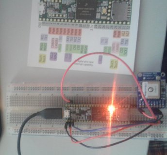

I'm trying to use the Adafruit Ultimate GPS whith an Teensy 3.6

But it's seem like the GPS don't send any data
The wiring is good cause the echo sample from the lib works fine on an UNO board an i use the same on the Teensy
I made a lot of resarch but I don't find any solution that works in my case
Can you help me ?
PS: Sorry for my bad english, I'm french

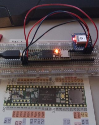

Have you got it wired correctly for a T3.6?
The GPS Tx pin goes to T3.6 pin zero
and GPS Rx pin goes to T3.6 pin one
Pete
Haha nice to meat you again ^^
Hum intresting cause compiler don't said me that PGCMD_ANTENNA was undefined
Yes Tx on 0 and Rx on 1.
Thx for that, i will try it tomarow
So first, my wireing (photo) GPS Tx --> T3.6 pin 1 (not like i said in my last reply)
GPS Rx --> T3.6 pin 0

I don't know what I did wrong with the Teensy cause it's work with my Arduino UNO :/
You aren't powering the board properly. The 3.3V pin on the GPS is an output. You need to connect the Teensy3.6 3.3V to the GPS pin marked VIN.
Pete
My quick look at your wiring picture (sortof fuzzy), I don't think you are powering the board... That is if I look at the pinout page, it shows hooking up to VIN on the board with 3-5 volts. The 3.3v pin is an output pin from the boards Voltage Regulator...
Ok so I connect the T3.6 3.3V pin to the VIN on the GPS and reconnect Tx and Rx in the good order but still no data
Aah... difficult to tell from your picture, but it looks like the pin headers are not soldered to the Teensy and to the GPS shield. Thus, there are most probably contact problems. After solving that, I would check with the oscilloscope if the GPS shield is really receiving the initialization data and if it is transmitting data in return.
No I have nothing to solder because I have 5 other components to make work with the Teensy and I test them separately
Dunno how I missed that (no solder).
It will not work unless you solder the T3.6 to header pins and then plug it into the breadboard. Similarly, the GPS must have header pins soldered to it and then you can plug that into the breadboard.
Pete
Indeed, the pins do not work until you solder them!
