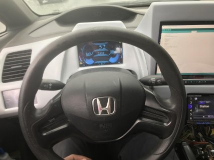

Ok. I give up, my curiosity has gotten the better of me now. What the heck are you doing that you have so much hanging off your Teensy?
https://m.youtube.com/watch?v=bEWWOAI2ocM
Wow. That's a project and a half. When are you going to add obstacle avoidance, lane departure, etc :)
that would be overkill no? ;)
both screens are on separate threads, but they are both using the same SPI bus to talk to the 8 expanders. both lcds are running at 625K baud uart speeds on serial1 and serial2 and data is always flowing from teensy to lcds as the animations are manually done by teensy as opposed by the lcd itself, so I can control them. Visually you can see the difference in speeds between before and now regarding the animations. They slow down on single threading because the 70kbyte code the loop has to go through before looping again takes time, especially with canbus and i2c devices being read all the time. now the 2nd screen has it's own dedicated loop and both are working at normal speeds now.
