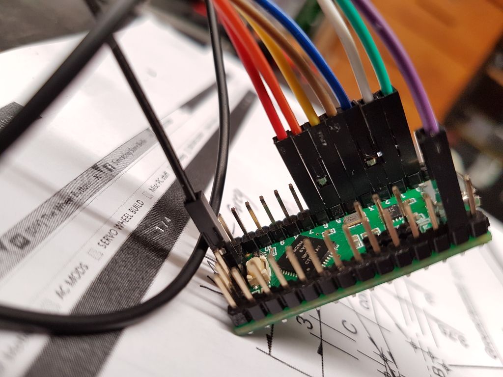

    Hey Kurt, Appreciate the help,
    Basically i will have a multitude of Standard N/O buttons that i want to act as a button of sorts, be it a joystick button or what have you,
    I also have an Alps Encoder that I linked in the first post that I have wired up and got everything working as i would expect on the multimeter but again cant get a basic button to work on the teensyLC, so haven't hooked up the Alps yet.
    The switch i have on for testing has 1 lug on the G and the other on pin 5 or 7 or 8 ive tried a few different pins....I think this is as baby step as i can take it hehe.
    Ive loaded soo many scripts from so many places i honestly dont know what ive all tested. Sorry to be so vague, The pinMode seems to be what im after.
    I loaded the bounce scrips you said and I got the LED to flash when i press the button....the Led also goes out when i Touch both contacts with my fingers..dunno why that is but ok..... So whats next ?
    here's what im seeing

    Ok so you have one pin on 5 or 7 or 8 Other lug on ground.
    So if you change the Bounce progam to be:
    #include <Bounce.h>
    // This code turns a led on/off through a debounced button
    // Build the circuit indicated here: http://arduino.cc/en/Tutorial/Button
    #define BUTTON 5   // First try pin 5
    #define LED 13
    // Instantiate a Bounce object with a 5 millisecond debounce time
    Bounce bouncer = Bounce( BUTTON,5 );
      pinMode(BUTTON,INPUT_PULLUP);
      pinMode(LED,OUTPUT);
     // Update the debouncer
      bouncer.update ( );
     // Get the update value
     int value = bouncer.read();
     // Turn on or off the LED
     if ( value == LOW) {
       digitalWrite(LED, HIGH );
        digitalWrite(LED, LOW );
    When you run this program is the LED off? If you push the button connected to pin 5 does the LED on pin 13 light up?
    The LED is Lit from the second i plug in the Teensy, If i press the button the light goes out. No recognition in the game Controllers.

    Again so far you simply have a program that it simply turns the LED on and off... In the updated program I had, if you now want it to be off when you plug it on and ON when you press the button, change the code above form
    if (value == LOW)
    to
    if (value == HIGH
    Or Alternatively
    if (value != LOW)
    Now if you wish for it to act like a button on a Joystick.
    You might try the example program Buttons, which you can find by first configure Tools->USB to be one of the settings which includes Joystick.
    Then go to File->Examples->Teensy->USB_Joystick->Buttons
    Looks like this program is setup to create 10 buttons on digital pins 0-9...

    Success, I got a Registering button, YAY...
    ok so You say the example button script is set for 10 button's which i can see, from 0 to 9....my Rotary if you looked has 10 wires, 3 of which are grounds. Can i gang those grounds together ? Also Each one of the Rotarty/hatswitch functions will be a "button" including the rotary part right ? How many Buttons plus the Alps Rotary can i get on the Teensy.
    Also how do i go about adding the encoder library or sketch to this ?

    Awesome!!! That worked as expected Kurt, the Encoder on pin 5/6 adjusted the X/Y Axis slider bar. So now question if I want the encoder to act as button pushes as well so how exactly do i code that ?
    And why do i want to disable pins exactly ? Is that to save in the loop calculation ? ?
    Im most likely going to want to have as many buttons as i can, I see the Joystick offer's 32 buttons, Is that 32 buttons factoring in what im using for the encoder already ? so that makes it 30 buttons ?
    How do i get 32 buttons from 23 digital pins ?
    Again Im terribly sorry for the rookie questions And if you want more info just ask.
    here's how i have the Alps wired, the white/grey, Yellow, Green and brown are the Up, down, left and right I have the Com attached to the Ground terminal and u can see i have the encoder Com on its own ground for now. Problem is when i add all these functions from the Alps, it seems to start to do "double presses" of buttons And im not too sure why.
