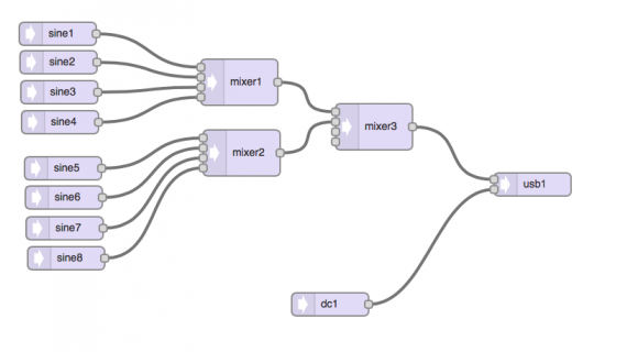

So I'm running into some problems I haven't been able to figure out. I am generating 8 sine waves, each sine representing a bit in a char. I'll change the amplitudes of each sine waveform, hold it for 5 ms, and then encode the next char. I also synth a DC waveform, this waveform's amplitude toggles between .6 and -.6 between chars. Right now I am just outputting the audio from a Teensy 3.6 via USB to my Mac. I can record the audio with Audacity. Later, when I'm happy with the signals I'll switch over to the Teensy Audio Shield.
I actually have this working... sort of. Their are some quirky things going on. For example; the DC waveform is only supposed to be on the L-channel, however is shows up on L&R. If i don't have an AudioOutputI2S object declared, there is no audio output through USB?? Adding other variables to measure the delay in micros() between encoding chars completely changes the audio signal.
Here are my instantiations of the audio objects. The AudioOutoutI2S is declared, but never used. Nothing will output through USB if its not there.

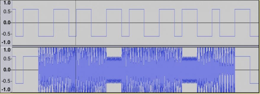

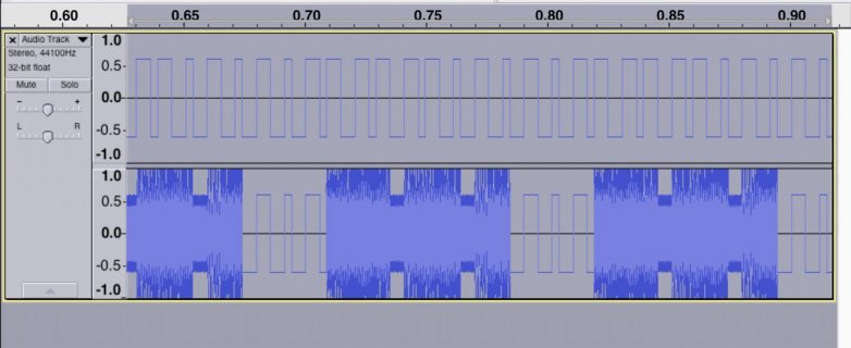

The waveform
So you can see the clock is on both R&L channels and the duration of the clock isn't as good as I would like it to be. However, the clk period is consistent with the period of the data. So I can still decode it. :eek:
Subtracting out the delay between encoding each char doesn't work either. It did't fix the clk period and for whatever reason it added the clk and sin waveforms...

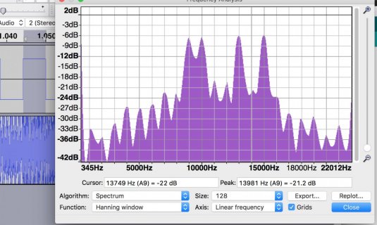

Frequency spectrum of 'e'. Looks good.

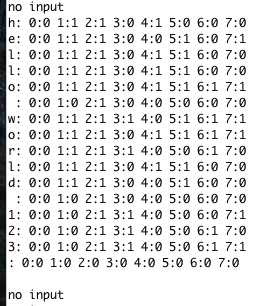

Printing out what bit in a char is assigned to a sine waveform.

The fact that the i2s output has to be included even if you are only using USB is a known "bug", or "feature" of the audio library. USB won't work on its own - you need some other output like DAC or I2S to actually trigger the audio library updates.
I am wondering why you are generating the clock in your sketch, instead of just including a synth object of type WAVEFORM and setting its type to WAVEFORM SQUARE? You then set its freq and amplitude, and it will give a steady clock. If you need to gate the clock on and off between characters, for example, you can just set its amplitude to zero for that time. The synth waveform object will generate a steady square wave of 50% duty cycle.You can also use the phase setting to start the waveform at a specific time if you need this feature.
I don't know why your DC waveform object, which is definitely only wired to one channel from the looks of your code, is showing up in both channels. I've used audio lib USB output, but only for a mono signal, and wouldn't have noticed something like this, if it is indeed. a bug in the library ( which I doubt).
