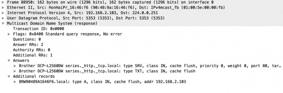

Using a static address and some further troubleshooting I managed to see a MDNS package on Wireshark. However it is being sent to destination address 0.0.0.0 instead of the multicast address 224.0.0.251.

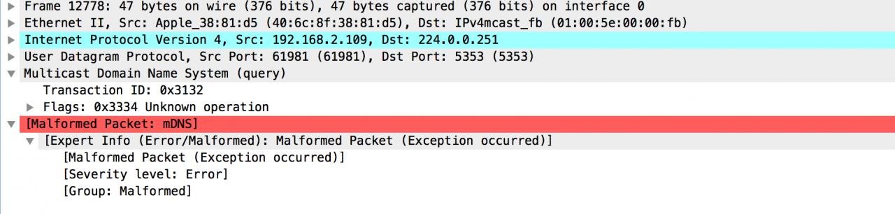

Using DHCP I see malformed BOOTP request instead of MDNS packages. Very strange - although the ip is set correctly and I can ping it.
It's sending this "semi-correct" MDNS package as it should repeatedly - so part of it is working. However Bonjour Browser will not see it and I guess it's due to the destination address not being the correct. Drilling down to the libraries, I cannot see where i looses the correctly set multicast address.

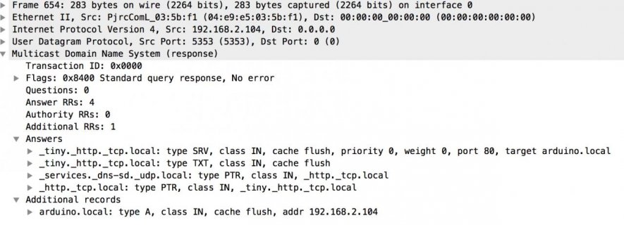

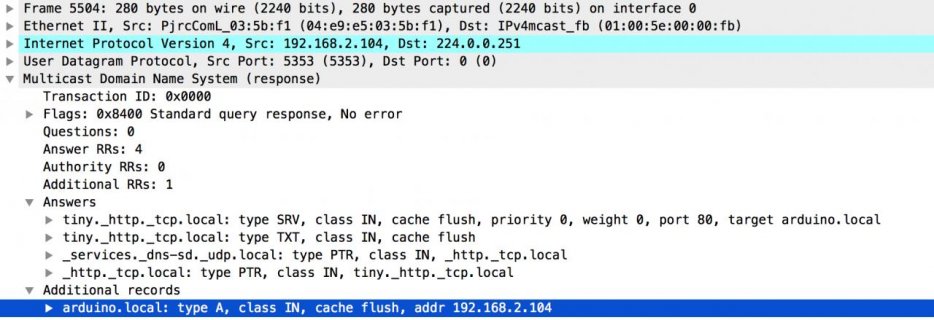

Thanks! I increased the array but obviously it doesn't solve my main problem. Destination IP address is always set to 0.0.0.0. I traced all calls from Bonjour down to the w5100 library and everywhere the correct destination ip address is set - it's lost somewhere. The payload itself looks fine and is a valid MDNS packet. The same thing happens when I create and send a Multicast UDP packet "by hand" without the use of the Bonjour library. Wireshark will report it as 0.0.0.0 but all other devices have destination ip set correctly (and these ones will appear in Bonjour Browser).
The library sets the SnDIPR and SnDPORT registers before filling and SPI transmitting the data buffer with a final execCmdSn(s, Sock_SEND), waiting until sent, then reporting success and writing back SnIR::SEND_OK to the SnIR register of the W5100 abstraction class. This is correct behavior as the SnDIPR and SnDPORT registers must be set before opening the socket itself which I thought could have been the problem but apparently the destination ip address is not respected either by SPI or the firmware of the w5100 chip....
No Bonjour for me... really bad ;-(

b) in regular intervals (2 mins) you should see the mDNS/Bonjour packet in Wireshark (set the filter to mdns or ip.src eq 192.168....). Since this is multicast the wiz820 will send a IGMPv2 membership report package automaticaly. This is the effect of the
int res = EthernetBonjour.addServiceRecord("tiny._http",80,MDNSServiceTCP);
line and is correct behavior.

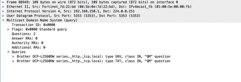

I have sniffed some samples of this request/response thing using my printer. see attached. This should show you how the packet should look like. I can generate the "Standary query response" which is the proactive method where arduino.local will send it's services without a prior questions/query in 2min interval. Too sad it doesn't show up in Bonjour Browser as the library readme indicates it should.

echo "1234" | nc -u -w0 224.0.0.251 5353
which sends the packet as attched in the picture.
upon receiving this (teensy side) this should at least generate some data at the
if (Ethernet.socketRecvAvailable(sockindex) > 0) {
line in EthernetUdp.cpp in parsePacket method. But it doesn't. one thing I know is that before OPENING the socket the registers must be set to allow multicast and setting the ip address of the one that mDNS uses (which is the correct in the library). Since the pool of the 4 threads will return socket 0 for udp/multicast (because we used the first opened socket for multicast and socket 1... for the webserver) the socket should listen to the multicast address. But it doesn't and I don't know why?!
Screenshot 2017-02-11 20.25.32.jpgScreenshot 2017-02-11 20.24.55.jpgScreenshot 2017-02-11 20.23.35.jpgScreenshot 2017-02-11 20.23.35.jpgScreenshot 2017-02-11 20.22.22.jpgScreenshot 2017-02-11 20.21.54.jpg
