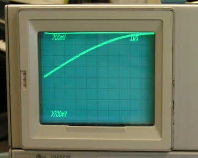

With the Audio Network Analyzer project, I found I needed to recalibrate the phase of the ADC-DAC path. This is with the PJRC SGTL-5000 Audio Board (and a teensy 3.6). I have explored this issue enough to understand the limitations this presents. The details are here in case any one else is doing phase-sensitive work.
NOTE - Nothing here should be of any interest to those doing audio processing for the ear. The ear will never notice a few tens of microseconds of shift!
First the results, and then the test setup. A signal is introduced through both line inputs of the ADC. This is directly sent to the corresponding DAC outputs of the audio board. The delay of this path, for the default 44117.65 sample rate is about 6350 microseconds. If the power is removed and reapplied, the delay through this path is often the same, but not always. A trial of 5 times showed 4 times for 6352 microseconds and once at 6358 microseconds. If the sketch is reloaded, the results are basically random, over a range of about 35 microseconds. Note that 35 microseconds is most of the 50 microsecond period for a 20 KHz signal, and for what I am doing is a big deal! BTW, both L & R channels track the shifts together.
That is the question of start-up, and for me just says that calibration is needed after things are powered down. This is OK. A second issue is that I use a combination of a 44.117 kHz and 100 kHz sample rates. I was worried that changing the sample rate would change the delay. As best that I can test it, it does not ever change the delay. My experiment changed the sample rate back and forth thousands of times with always consistent results for both rates.
And the method of testing this. I hooked up a HP33120A waveform generator, set to produce a square wave. This instrument is crystal controlled and can be adjusted in 0.01 milli-Hz steps. This went into the ADC inputs, and also was used to trigger an analog 'scope. The output of the selected DAC went to a second channel of the 'scope. The frequency was adjusted until the half-voltage point of the rising DAC output exactly lined up with the rising edge of the square wave. By choosing the lowest frequency for which this will occur the period of the square wave is the delay through the path.
The sketch is pretty simple, but included anyway:

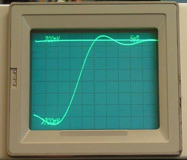

Hi Paul - Here is a bit more on the experiment to supplement what was in the original post. Really not all that fancy.
The HP waveform generator uses DDS synthesis and is thus tied to an internal 10 MHz crystal oscillator. This makes using the period of a full square wave as the reference both exact and, for practical purposes, jitter free. The 'scope is my long-time friend, "Old Faithful," a Tek7704. The scope could be almost anything that had two traces, though. All we want to do is make the rising edge of square wave line up with the middle of the DAC output waveform by changing the frequency of the square wave. When this is done, you don't see much, as half of the DAC waveform is off the screen. So it looks like:
In this case the HP says the frequency 356.656 Hz with a period of 2803.8 microseconds (this is at 100 kHz sample rate). The trace is at 1 microsecond per division, so the accuracy of the measurement really must be a part of a microsecond. And, of course, the scope shows the DAC output from an input that occurred a full square-wave cycle earlier. One more shot shows the full waveform of the DAC output. This was achieved by changing the generator frequency by a few Hz. This picture is from a few days ago, and may not be in full agreement with the 'scope picture just above. For sure the scale has changed.
Unrelated to all this is the obvious pre and post rise ringing. Nobody shroud be concerned---this is good! The symmetrical "pre" and "post" means it is a linear phase FIR filter with symmetrical coefficients. The ringing is just a result of the ADC/DAC fast frequency cutoffs.
