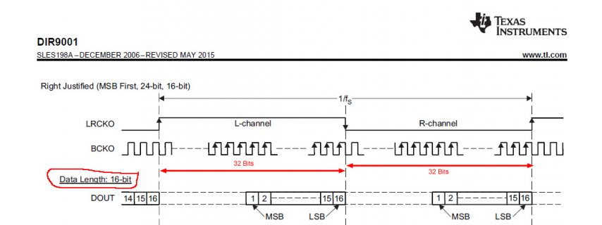

So, I'm embarking on a project where I will attempt to use this TI Chip:
http://www.ti.com/product/DIR9001/description
to decode an optical TOSLINK input and send the audio samples to the I2S Receiver of a Teensy 3.x for use by the Audio Library (namely FFT).
The Teensy's I2S Receiver will have to be in slave mode so that the DIR9001 can supply the bit clock and frame sync synchronous to the original sample rate of the TOSLINK input.
The only hitch I see is that the TI part has a fixed frame size of 2 words (Left and Right channels) and a fixed word size of 32 bits (i.e. 64 bits per frame). Knowing that the Teensy Audio Library operates on 16 bit samples, I've identified the settings in the TI chip to select 16 bit right-justified data in the 32 bit Left and Right channel locations:
I've also gone through the MK20DX256 datasheet and identified the register settings necessary to support slave mode and 2 x 32 bit words (64 bit frame).
My only concern now is will the I2S Input, AudioConnection, and other facilities of the Audio Library properly pull the 16 bit samples from the lower 2 bytes of each 32 bit sample word. I'm a decent C coder, but don't know C++. So, I get pretty lost looking at the Library source code to find the answer to this question.

OK, I've succeeded in decoding an optical TOSLINK signal and feeding it into the Audio Library. The TOSLINK ---> I2S conversion is done by a TI DIR9001 (datasheet attached). Setup looks like this:
The DIR9001 feeds 16 bit L and R samples embedded in 32 bit words (64 bit total frame size) to the Teensy's I2S RX input. See page 24 of DIR9001 datasheet. I created a new 'AudioInputI2S64Slave' class that extracts the two channels and feeds proper 'audio_block_t' samples to other Audio Library objects. All timing is derived from the sample rate of the incoming TOSLINK signal. So far, I've tested it with fs = 44.1 and fs = 48 KS/s.
I've also created a new 'AudioOutputAnalogI2S' class to synchronize the Teensy's DAC output to the incoming I2S signal. It does this by using the LRCLK input (essentially a clock at the sample rate) to trigger the DAC's DMA transfers. I use a separate input (Pin 2) for this trigger because I'm not sure if the LRCLK input (Pin 12) can simultaneously be a DMA trigger.
When I receive the Teensy Audio Shield that I ordered, I'll create a similar class to synch the Teensy's I2S Transmitter to the TOSLINK input. Then it can drive the CODEC on the Audio Shield to produce stereo output.
All code is below. Note, I'm not a C++ programmer (yet). So, I created these new classes by modifying the existing ones from the library. But, they are separate, independent classes. I did not attempt to make them sub-classes of the current ones with property inheritance, etc. Also, they're only coded for the Freescale MK20 family since all I have is a Teensy 3.2 board. I'll leave proper integration into the Audio Library and implementation for other processors as an exercise for an interested C++ coder. Right now, these implementations meet my needs.
