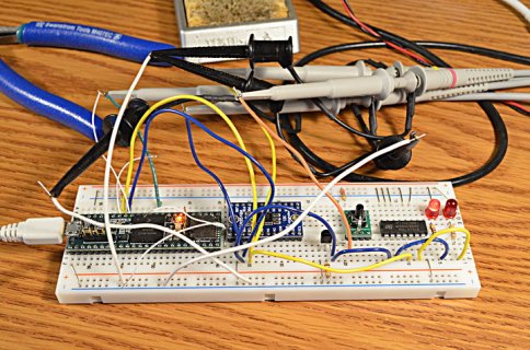

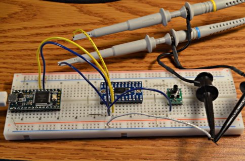

I've been continuing to look into this problem for the last couple days. If anyone's wondering why I've been so quiet the last couple days... this is it.
As you can see, I've added a little more hardware to test. A 74HC08 chip buffers the signals and drives two LEDs. I also added a 2N3904 NPN transistor to pull down on the SDA line when the button is pressed. This allows viewing the base voltage, so it's easy to see on my scope when the button was pressed.

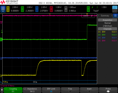

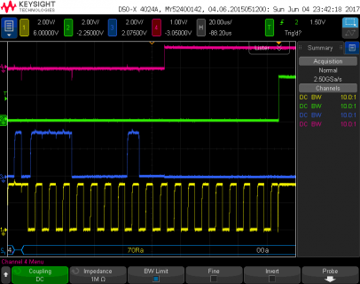

This is turning out to be a really tough problem, but it's looking like Freescale's arbitration lost feature is getting triggered if the transistor (or the noise in your system) happens to be forcing the SDA line low at just the wrong moment at the beginning of the last ACK bit time.
The red trace is the NPN base voltage. In this test, the SDA "noise" is starting just after the address byte.
The green trace is pin 13, where I've added a digitalWriteFast to drive it high the instant I see the arbitration lost flag.
I believe what's happening here is the I2C port quickly releases the bus because it believes another I2C master has control, but another master isn't actually in control. The result is SDA goes high almost immediately. Here's a zoom in to what I believe it likely the problem point:
That low pulse on SCL is only about 250 ns wide! No other master is actually taking control here. :(
The TCA9548 chip probably has a low-pass filter to reject stuff much higher than 400 kHz, so it's probably ignoring this pulse. So from its point of view, the master still hasn't completed the ACK bit cycle. It keeps driving SDA low, forever waiting for the master to pulse SCK and generate the stop condition.
At least that's what I think is really going on here.
How to properly solve this is something I still haven't figured out.....
