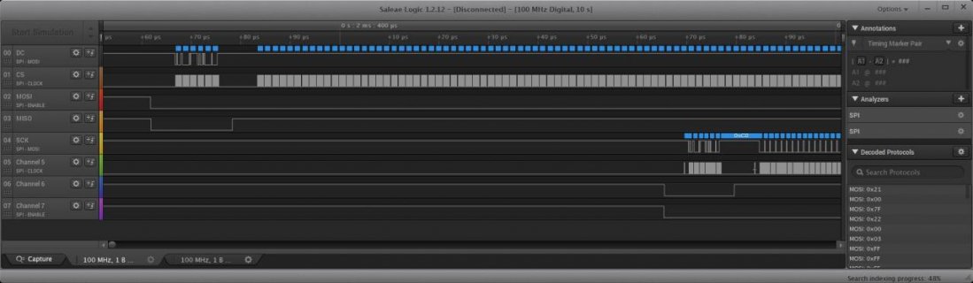

Note: I put in a Pull Request to core project to fix DMAChannel.h issue I mentioned.

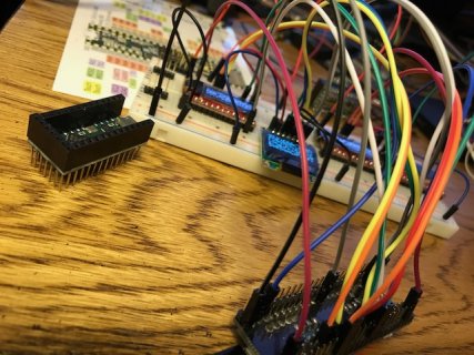

I now hae test program driving 3 Teensyview displays. The Test code is a mess, but, it tries to run each of the tests or partial tests without blocking the rest of the system. I had them running with no delays and I had the my Logic analyzer showing two of the three buses:
with MOSI, SCLK, CS, DC So the two were using all 8 channels.
Maybe later will use my older 16 channel one for all three buses. ...
This appears to be working well enough to beat up SPI Async code... So far so good for T3.6. Probably next setup will be to try on
T3.5 all three busses. Then T3.2 1 and TLC 2...

Yeah - The above program also works on the T3.5 on all three displays using DMA on all three SPI buses!
Again if anyone is interested in trying anything out, my current code for SPI including the One class, plus new transfers is up on my
fork of SPI (github/kurte/SPI) in the branch SPI-multi-one-class
I also pushed up my experimental version of the Sparkfun_Teensyview project in the branch Multiple-SPI
And currently my code is setup to handle 3 displays one of which is a 128x64 and others are Teensyview 128x32
Nice. So those three are all full (tiny) RAM buffered and the DMA is running from that RAM? Running in Parallel with full SPI speed (longest blocks with short gaps) with minimal overhead to tend the interrupts. No flashing or screen artifacts?
Yes all three of them are SSD1306 SPI devices. The TeensyView ones have a 512 byte ram buffer (128x32/8) and the larger one has a 1K buffer (128*64/8).
The updates to the display are done with new method for Async update:
Which does beginTransaction and asserts CS and DC uses SPI to do the DMA write of 6 bytes for the header.
When it's callback is called it unasserts DC then does an Async write of the buffer.
When the callback is called again it unasserts CS and does end transaction.
With the test it is working pretty well. Still playing with the test some to see other issues. For example I am adding the scrolling text like example that the Adafruit test does, but using the methods that were defined in the Teensyview header. Found out several were not implemented...
The test method is not the greatest I have ever done, but I did not want it to work like the original which would do things like:

With the DMA, the display running on SPI appears to run OK but the one on SPI1 not so well. So hooked up logic Analyzer and try looking at signals:
One thing I am noticing on SPI1, is each time I start a DMA transfer, the clock pin does a brief pulse (something like 60-80ns)... It does not happen on the SPI0 buss.
Note in the above picture the first 4 lines are for SPI and last 4 are for SPI1. You will see that there are two dma transfers there and you can see the little blip on the clock line on both transfers
My guess is it has to do with starting up the DMA transfer. The code currently does:
<  setup dmaRX and dmaTX for the transfer>
	port.C1 &= ~(SPI_C1_SPE);
	port.C2 |= SPI_C2_TXDMAE | SPI_C2_RXDMAE;
	port.C1 |= SPI_C1_SPE;
    _dmaRX->enable();
    _dmaTX->enable();
I think next up will setup an example program using the DmaSpi library to see if it shows the same. Earlier looking through their code it sort-of logically did some similar stuff, although the part the re-enables SPI-C1_SPE was actually done by it calling out to SPI.beginTransaction...

Yesterday and Today - Did a quick implementation of the Async call: transfer(buf, retbuf, cnt, callback)
for the AVR. I thought I had a second T2.0 around here but did not find it so tore apart Lidar-lite unit that has one in it and now have the demo running on a TV connected to it... Obviously the speed is not as good as the Async version works by using ISR for each byte of the transfer.
I pushed update to my SPI library fork/branch
Plus Updated my Sparkfun_TeensyView library - Where I removed all of the code that was trying to manipulate SPI registers directly but instead relies only on this new SPI proposed changes.
If anyone is interested could upload current Test program that is outputting to SSD1306 displays. Next up will probably do another SPI test app, to test the Async API in Read mode and Transfer mode...
