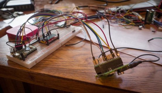

KurtE, I signed up for the E-paper shield (https://www.crowdsupply.com/soniktech/e-paper-shield-kit) after the initial crowd funding campaign. They claim the second wave of boards will start shipping at the end of April.
I looked into the code, and it appears this board can't be optimized, since they use non-standard CS/DC pins. Though I'm not sure it is important to optimize an e-paper display.
As far as I can tell from the code, the pinout looks like:
  • Pin 11, MOSI
  • Pin 13, SCLK
  • Pin 14/A0, BS (appears to be input to signal when the board is ready)
  • Pin 15/A1, RS (reset I assume)
  • Pin 16/A2, DC (I assume SPI D/C pin)
  • Pin 17/A3, CS (chip select)
  • Pin 18/A4, i2c SDA
  • Pin 19/A5, i2c SCL

This morning I tried hooking up audio adapter... There code is setup to take line in values which I don't have setup on it... But have the microphone plugged in...
I commented out the attempt to change SPI object in Serial flash code so I could build.
Currently running on my updated version, that is simply using my new transfer(out, in, cnt) version, which is not making any use of hardware CS/DC and it looks like the display is updating every 2-3ms CPU=99 mem=18... The display sort of flickers... as it updates this fast...
Might try again in a bit with turning on the other more complex code that tries to use the hardware SPI. However probably won't be much different, as the SPI.transfer(buf... ) code works pretty well and uses the 16 bit writes and the like to keep the buss as full as possible. But has to wait until queue is empty before changing DC (so probably 8 times per screen update)
I suppose the audio lib runs as fast as it can and doesn't count display update time? CPU use on SFUN vid was 77% now up to 99% when loop was 8-11ms. { crossed thread here }
Interesting you are just seeing the flicker doing the bar updates when at loop=2-3ms. I'll look to make time to hook one up to the PJRC T_3.2 Audio demo protoboard in place of the TFT and use the HDW SPI lines. I have a bottom pinned audio board I made for the K66 beta - have to check I can do that and get out the other SPI's.
The last test was done with a not very ideal setup for SPI speed.
But as you can see Audio adapter plugged into top of Teensy, plus then used jumpers to test setup...
Thanks - if that works with those wires I should be able to match it. I'll just pin one TeensyView like yours into a baby breadboard.
Tried on the T_3.2 audio tutorial board - failed to connect somehow, conflict with analog or dome other chosen pin - just got garbage of a sort, sometimes real stuff - moved to a lone T_3.2 same pins to confirm I didn't break the display and it runs.
Just noticed the VIDEO is done with a T_3.6 on the 8-11ms updates at FFT usage of 77% - as noted on SparkFun 99% is the twin FFT's on a T_3.1. So maintaining the FFT's and faster refresh is impressive. Though bumping up SPI clock does a lot to the samples I ran.
