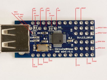

    Hello,
    I'm using my Teensies 3.1 with USB Host shields from Sparkfun. I've found them to be a pain but still - they work. So that's that. The problem I have is that they're big and so I've set out to find a smaller factor USB host shield. And wouldn't you know it. I did. On a Chinese store. They seem to be a rip off of other USB boards for Arduino Pro mini. Iíve decided to give it a try but Iím encountering problems with them. The thing which I want to connect to teensy is a PS4 controller.
    Iíve replicated the connections from the Sparkfunís shield and when running USB Host shield Library 2.0 Iím getting
    ďPS4USB Wireless Receiver Library StartedĒ
    message on Serial and thatís it. No response from the controller. Iíve connected the external 5V power to the USB from Teensy (cut the Vbus track first) and still nothing. Maybe thereís something I did wrong with the wiring?
    I was wondering if someone smarter than me could take a look at it and maybe point me in the right direction.

    A link to the library would be good. Assume the only 'docs' available from the ebay site is the picture there?
    Fault finding this will involve getting some basic familiarty with SPI
    first page or so of here would be the bits:
    https://en.wikipedia.org/wiki/Serial..._Interface_Bus
    First place would be to make sure all the power pins have the right voltages.
    Suggested next step is to look at what signals are supposed to be where. So sck is on pin 13, so the LED on the teensy should flash when it's talking either way.
    Chip select (SS) should be going low whenever SCK is active (use a scope, good meter or just add an LED)
    D11 and D12 (data in/data out) are a bit trickier but there should be data to the sheild, then data from it. In this case seeing if any data is coming from the board would be useful (responds to Teensy commands).
    The labeling of D11/D12 and PCB markings /MOSI/MISO do not look they conform to Arduino standard, so it may be a case they are swapped but proving that is a bit tricky.
    Reading the library would be required to know if the INT pin is supposed to do anything.
    This is of course the price to pay for buying cheap ofg ebay - you get to learn a lot more about how it works.
    You don't have a photo of the top of the board, have you done a basic trace to confirm the IC and PCB look at least something like the info at:
    https://web.archive.org/web/20160812...hield_projects
    and
    https://web.archive.org/web/20150503...HS_mini_10.pdf
    It's not impossible somebody has sold a USB host shield with some other IC on the thing.

    Your assumption is correct. That is the only source of info I have. Looking at it in comparison with the original board there are some differences.
    MY BOARD Click image for larger version.
    THE ORIGINAL Click image for larger version.
    the biggest problem is with finding GND (I'm guessing it's in the same position as with the original)
    As for the pin alignment - I have yet to trace each pin though. At first I was thinking of doing a little trial and error configs but your tracing suggestions seems more 'appropriate'
    Cheers,
    Rafał

    Re Gnd, should be on the shell of the USB socket as a starting point for what they have done here
    Looks like the boards are using the same core IC, and look to be wired in similar ways, so that's a good start.
    The data sheet for the IC is
    https://datasheets.maximintegrated.c...s/MAX3421E.pdf, page 10 shows the pinouts, unfortunately rotated 90 degrees from the PCBs, but looking at the reset pin, which seems to be the same place for both PCBs it looks like the traces that I can see are going sensible places (USB D+/D-, GPIO). Whats not clear is how those critical SPI pins are connected up. Chip select is visible, but MISO/MOISO are running under the board so harder to work with photos. Suggest wiring up up how the 'instructions' say and with power off try to measure resistance from Teensy Pin 11 (data out/MasterOutSlaveIn) to the IC pin 16 (left most of top row in the photo, two left of SS/chip select) then go pin 12 teesny (Din/MasterInSlaveOut) from pin 15 (second from left on top row).
    That gets you an end to end measure of the two most likely contenders for trouble, given there is different labels shown there.

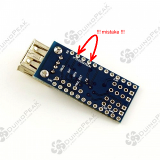

    but I’m encountering problems with them....No response from the controller....Maybe there’s something I did wrong with the wiring?
    i successfully connected this shield (DuinoFun UHS mini v2.0 Aug. 16,2014) to Teensy 3.2.
    The main problem with it is that they have been mistaken with MOSI<->CLK pins naming on backward board side
    connection:
    INT - pin9
    SS - pin10
    MOSI (BE AWAIRE! on backward side it named as "CLK") - pin11
    MISO - pin12
    SCK (BE AWAIRE! on backward side it named as "MOSI") - pin13
Name:	DuinoFun UHS mini v2.0 Aug-16-2014 Mistake.png

    Thank you both @GremlinWrangler and @SergeyM. Your input has helped me to get mine up and running! Yay!
    Cheers,
    Rafał

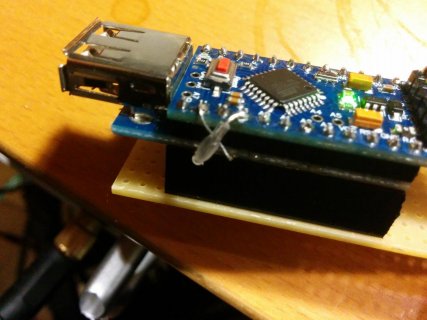

    I just wrote and released a library to connect with a Boss MS-3 multi-effects processor for guitar and bass. That library depends on the USB Host Shield 2.0 library and extends the USBH_MIDI class.
    I have a fully working set-up with an Arduino UNO and full-sized USB shield, but I want to downsize my set-up to implement it in a small foot controller. So I bought an Arduino Pro Mini running on 3.3v and an USB shield that should be compatible with the Pro Mini. Both cheap Chinese clones. I want to get my library running on a Teensy too, but I haven't ventured into that world yet.
    Anyway, when I start the Usb layer I never get passed Usb.Init().
    if (Usb.Init() == -1) {
        MS3_DEBUGLN(F("*** USB Init error"));
        while (true);
    I Googled into this thread where it was pointed out that the MOSI and CLK were swapped on the board, so I swapped the pins on my shield too by pulling the pins from the header and added external jumper wires.
    There are no off-board components connected, except for the USB/FTDI interface to my PC.
    I then verified that the INT and SS pins are correctly set in the USB Shield library / UsbCore.h:
    /* shield pins. First parameter - SS pin, second parameter - INT pin */
    typedef MAX3421e<P10, P9> MAX3421E;
    So my best guess is that INT, SS, MISO, MOSI and CLK are correctly connected and configured, but still the shield won't init. MAX_RST is also HIGH.
    Now, I understand that this isn't a Teensy, but I hoped your experience would give me that little pointer to get me coding again. I do apologise that I broke the rules.

    There's an attached image of my set-up in my post, but I'll add it here in case it doesn't show:
    The 3.3v version is the only one supported, as all i/o should be on 3.3v and not 5. The shield for the UNO utilizes 74HC125D chips for the conversion from 5v to 3.3v, IIUC.

    Ok, I tried three things tonight:
    1. Hook up my spare shield to my UNO
    Result: the same usb init error.
    2. Trace the pins from the MAX3421E to the headers:
    1 - 14 SS
    2 - 16 MOSI
    3 - 15 MISO
    4 - 13 SCLK
    24 - 18 INT
    Wait, what?!? That's the same SPI pinout as my Arduino Pro Mini! So the pins line up, but the silkscreen is wrong ... and it also doesn't work like that
    3. Hook up the UNO again and use the traced wire positions: nothing.
    I'm calling it quits for tonight. I'm going to think this one over and maybe give it another try this weekend ...

    Quote Originally Posted by Spitko View Post
    MAX_RST is floating
    Mine is connected to RST on my Arduino Pro Micro 3v3.
    And a update to my post above: I bought a new mini USB shield, and that one works out-of-the-box without any pin rewiring! On closer inspection, the 12MHz crystal looks damaged, so that might be the issue with the first shield.
