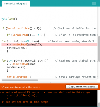

I've implemented the code you shared but I am now getting an analogread error message regarding 'x' (See attached below)
Is this because the code for the digital pins has to be changed also to work in conjunction with this new defined array?
Apologies if this is trivial stuff but this is the first time i've encountered this problem.
Thanks again for the speedy response!
Did you accidentally delete the line
int x = 0; // a place to hold pin values
before setup? I didn't mention it explicitly since it was clear for me that it would remain there. You never can use a variable in C/C++ if it has not been declared in the correct scope before...
The digital pin stuff may remain as is.

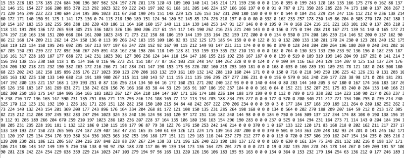

It looks like all the analog pins are now being recognised so that definitely helped, but I'm still faced with this constant fluctuation...
Would you have any other ideas on what the problem may be?
Yes, I probably have. Unfortunately, you neither posted pictures of your wiring, nor a schematic. But I guess that you
1.) didn't read well the Teensy reference manual which stated that the varying input impedance of the analog pins (due to the switched delta-sigma-conversion) requires potentiometers between 5k and 10k, higher values will give unstable readings and that there should be a 10nF capacitor between each analog pin connected to the wiper of a potentiometer and ground.
2.) didn't connect the ground pins of the potentiometers to the AGND pin of the Teensy
3.) didn't add a 10uF capacitor between the hot pin of the first potentiometer (which should be connected to 3.3V) and GND
You should add the potentiometers one by one while connecting the remaining analog pins to AGND, check the readings, and the corresponding voltage levels with your oscilloscope. And only add the n-th potentiometer after all others from 1 to n-1 are working correctly. That's systematic electrical engineering!

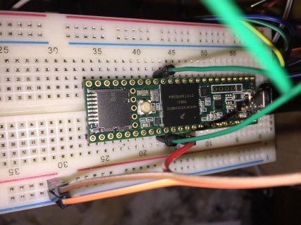

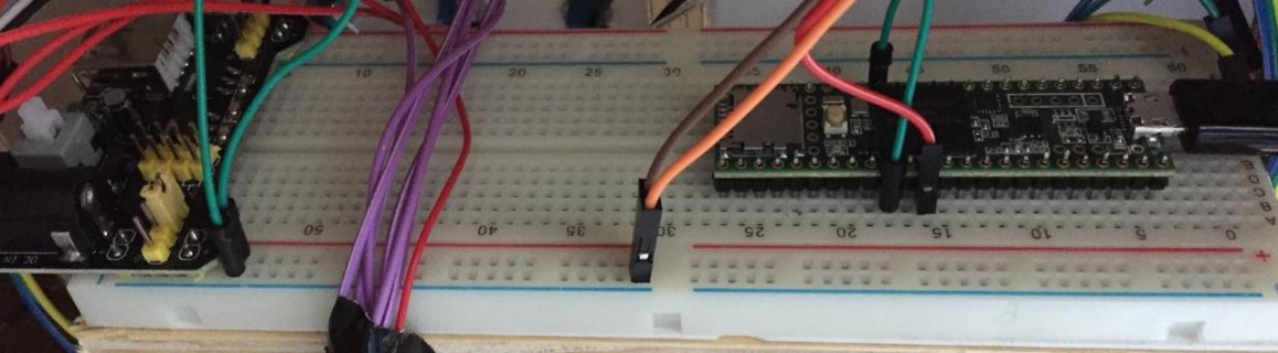

I did not previously draw up schematics, I researched the possible ways to approach my project and got it working on a smaller scale with the teensy 2, my background is in visual programming languages so the world of building physical circuits and arduino is still unfamiliar.
I've attached some photos below and just in case it's not clear this is for a single potentiometer with the middle pin (RED) connected to the A0 pin on the board and the outer pins (BROWN & ORANGE) connected to the breadboard power and ground which are connected to the boards 3.3v and GND pins.
Here's hoping i've just been staring at this for too long and missed something obvious..
There is something very obvious and now I understand why that is not working: YOUR PIN HEADERS OF THE TEENSY ARE NOT SOLDERED!!! THAT CAN'T WORK!!!
oh man... there is no warranty that every pin header has contact in the Teensy's holes if they aren't soldered.
Second... You power the Teensy from USB AND from the board supply. That risks to fry things. Either the one or the other.
Yep, that's the worst. Though you appear to have both USB power and power to 3.3v. That could be a problem that could cause damage? maybe do away with the 3.3v feeds, keep the common ground to your other power supply that feeds 3.3v to external devices. i'm not the one to give electrical advice :)
@manitou I did consider this yes, however I only started to use the power supply as when I left it simply to USB power the board kept disconnecting due to "too much power being drained from my computer" maybe I should look into your suggestion though.
I better get the soldering iron out then..
of course it was something as obvious as that...
Thanks a lot for the help guys, really appreciate your time. I'll solder up the pins and hopefully things start to go more smoothly!
