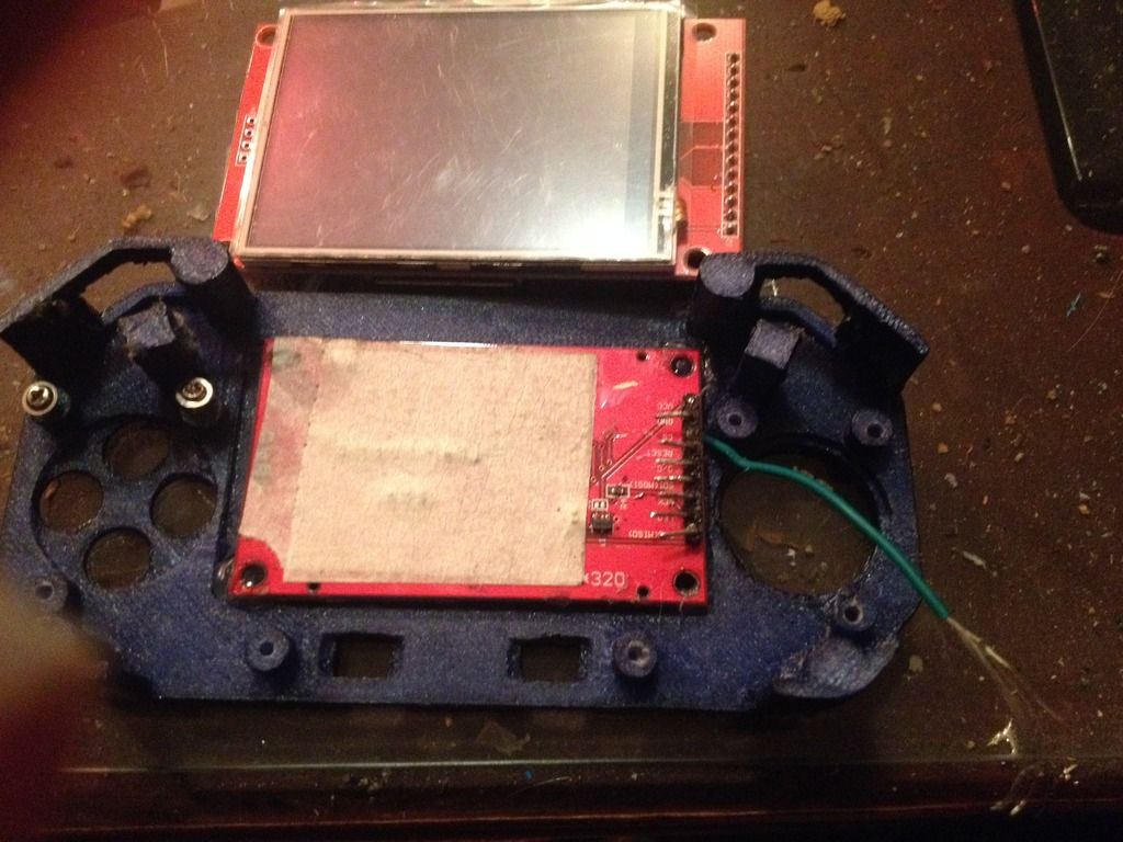

    One corner of the tft does get hot. Yesterday when i left it on to see the actual time till it died and there was enough heat that it had melted and warped the case it was imbedded in.
    I found this lil doohickey here........
    https://www.ebay.com/itm/121868205078
    Should drop my voltage from 3.7 to 3.3v

    One corner getting hot enough to melt isn't right, Since there isn't any photo's would guess that the backlight is intended for 3.3V and has been connected to 5V.

    Yea I do have the Vcc and LED pins connected and supplied at 5v. Guess that was a no no. I don't mind the contrast being a lil lower and I think I have the contrast as pmw and set at 60%. I think I have to look at the code again.
    All right I had dig out my meter but I tested the out put of my stepup and it shot up to 7.04 and 7.08v!!!! How has that not killed my teensy. I can test other stuff but you will have to instruct me on how to to do each test.
    Thanks Paul for your explanation on the restock.
    Hold on for pics.........

    Ok here are some pics
    This shows the screen in its case for orientation.
    If you look at the left side of the screen you can see how the plastic warped up a lil. You can also see where the hot glue melted the case when installed the screen.

    If you measured unloaded the 7V is not surprising because of the way the boost circuits work. if it was 7V with the LCD etc connected that would be very much a bin job. Useful tests at the moment are the voltage on your rig while loaded, and with meter set to current (will need to move leads and a 2Amp scale) measure in series with the output of your boost converter (red or black doesn't matter, whichever is easiest to access).
    Swapping your LED input to 3.3V will also be interesting. Different boards are around but the cheap way to build it would be white LEDs in parallel with a single series resistor. Given the ~3V drop of white LEDs that R would be quite small giving a fair heat dump when run on 5V

    Something is pretty wrong with with the meter, the teensy or where things are connected to have 4.58 on the teensy 3.3V pin. If real the teensy is really dead. Since it seems to be still working means you can't trust your measurments. You really want to sort that out since pretty much all chasing of your power from here will involve measurments.
    The LCD should be able to run on 3.3V, but try the 5V on VCC to start with, your LCD is different to mine but if you get that far check the solder jumper just above the little black object in the photo above, on the edge of the tape. Most likely the three pin device is the onboard regulator and the jumper is how you bypass it for 3.3V use. Don't try that until you have a much better handle on your wiring though.
    Other than sorting out the meter next step may be to see if the display still gets hot now the LED power is 3.3V. And getting it to communicate again.
