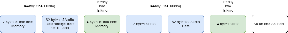

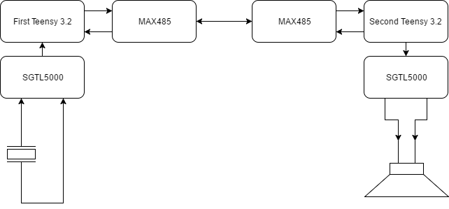

Above is my top level physical layer. In essence, I want to DMA 2 bytes of separate memory data + 31 samples of 16bit audio from the SGTL5000, push it to the serial bus at 1M Baud through differential transceiver from one teensy to the other, and then stop to wait for a response. Concurrently as the data shows up, the second teensy pulls off the 2 bytes of separate data to update a variable and pushes the 31 samples to I2S for the SGTL5000 to output as audio. Upon completion of the 64 bytes, it will send 4 bytes of data back. The first teensy then gets the go ahead from a short routine that it received back a value and starts streaming the 2 bytes and 31 samples to repeat the cycle. Below is what I hope the traffic to look like on the RS-485.
So my question is, is this feasible with Teensy 3.2 DMA controllers interfacing with I2S and serial? The two bytes and 4 bytes of info are values that get updated somewhere in loop(). I know this requires alot of special setup, which I am willing to learn, but I would like to know with reasonable confidence if its feasible before I start digging.

Thank you for your reply, however my main reason for going to digital transmission is because the power and ground connection between the two teensy's is very very noisy causing cross talk on the analog line; adding that I can use a differential audio signal to remove the noise but I cannot provide digital communication between the two teensy's on top of the balanced analog audio. I am restricted in that I have 4 wires between the two teensy devices, one for power, one for ground, and two for differential digital transmission.
What I would like to know is, can I create a DMA architecture which talks between I2S, memory, and Serial to minimize overhead to the CPU?
I will try that then and avoid the DMA stuff for now. I have had success with lower frequency bidirectional (around 4800 baud), but I haven't tried pushing the speed. I really do need to send some information back down the line to the transmitter, so I suppose I could extrapolate the lost samples during this time period.
I do understand that the complexity of a bi-directional protocol would require me to "figure out" what happened if a bit got flipped or something like that to cause the back and forth traffic to halt.
It’s not clear to me how you will be synchronizing the I2S interfaces (i.e. MCLK) of the two Teensy / SGTL5000 pairs on each side of your serial link. It looks like the Audio Library code normally sets up the I2S subsystems to derive MCLK from the processor’s clock. The two Teensy processor clocks will not be frequency synchronous to each other.
Typical solution for this is to maintain a short buffer on the receiver, and then slowly servo the consumption from the buffer (either reusing a sample, or dropping a sample) to keep the buffer half filled. The clock sync on the 2 Teensy will be close enough such that sample dropping/duplication should be rare (assuming the middleware doesn't have variable latency between serial peripheral and the buffer).
I can confirm, this is true. Pumped in a sinuisoid on one teensy, serial over, and the output on the other teensy didn't show any drops or duplications or phase cut-ins when I looked on my scope. I would have expected some phase cut-in differences because I am sampling for the queue faster than the queue should be filled... but it works and I will not question black magic.

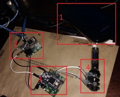

I will post up pretty pictures and code for reference later today.
Picture Description
1. Audio Source
2. Recording Teensy - Push queue samples over Serial1
3. Playback Teensy - Receive queue samples over Serial1
4. Audio Output
Important Notes:
- Serial1 buffer size increased to 512
- Guitar Tuner block size decreased from 24 to 6
- Serial1 connections kept short (transmitting at 4Mbit)
- Bidirectional is not implemented here, because its not physically implemented with the proposed RS-485 chip as previously mentioned in the original posting. Read interesting note below.
Interesting Notes:
- Using a IntervalTimer to catch recorded queue samples at 2909us, when it is the only code works correctly as this is the amount of time between 128 samples being filled. Once you add some other audio library stuff like Yin Algorithm in guitar tuner, it drops samples because it gets interrupted? Inserted highest interrupt priority for IntervalTimer, and this is still the case... So, set IntervalTimer at 2100us, all is well, no skipping.
- One would think that over sampling the queue samples would cause phase jumps in the receiving buffer... it does not, as verified with the scope. I am not going to question this (black magic). Must be something related to how queue points to the samples (head vs. tail).
- There is a lot of time to send back a receiving message ontop of the serial data. The recording teensy can tack on data at the end of the audio packet. The playback teensy can transmit a few bytes back immediately after data is received. The only forseeable issue is that the playback teensy doesn't send its data fast enough before the next packet arrives and cause a collision.
