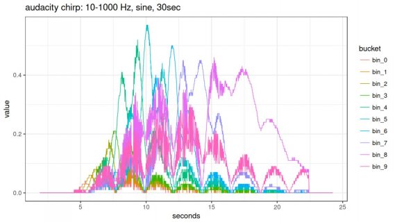

I wasn't sure how to title this. I have an LED 16x16 matrix and I'm trying to create a simple spectrum analyzer/reactive music visualization. I thought it was working (lights more or less "bounce" with the music), but when really listening for high/low and watching where the action was, I got the sense that something wasn't right. I used audacity to send a min-max frequency (10-1000 Hz in this case) sine and square wave over 30sec and now see that the thing is pretty much haphazard.
I replicated the circuit that pops up for the adc input at the audio library design tool. I'm essentially replicating the AudioSpectrumAnalyzerBasic code, other than adding the mapping from a frequency level to some number of LEDs to light up. I'm using a teensy 3.2, and it's hard to capture, but pictures to examine my wiring can be found here.
To illustrate the behavior, here's a youtube video showing the LED strips lighting up during the test (bottom is level[0], top is level[15]). The also contains the output of the fft.read(min, max) plotted over the span of the audacity chirps; I was worried about embedding as some forums care about size... I see they're scaled anyway, so here you are:
sine:
square:
This was collected via the serial monitor, and since I'm going to 1000 Hz and using AudioAnalyzeFFT1024, I did 1000/47 to see that this should only light up to ~fft.read(21), which is in my level[8]. There's activity all the way up to level[15], but plotting curves by color isn't great when using so many bins so I reduced to level[0] through level[9] for plotting.

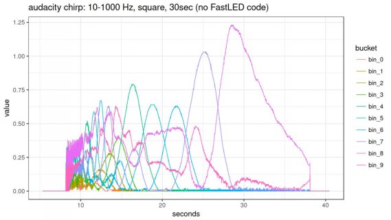

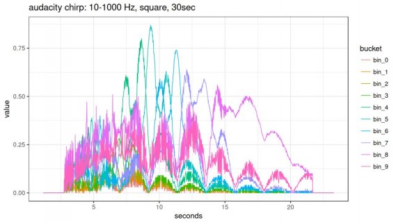

- FastLED interrupts: I figured this is what the first line of my code turns off. That said, I re-ran the test with all of the FastLED stuff turned off (just reading the teensy). It does look different! Here's the with and without FastLED code with a 10-1000 Hz square wave results:
with FastLED code (also in post above):
without FastLED code:
It's a little hard to see, but if I follow bin_8, it's the furthest right huge peak... it also goes wild from 5-12 sec, has a mini dip and then pleateaus from maybe 17-25sec, then a huge dip at 25, and the big peak (which is probably where it should trigger at almost 30sec.
That said, it's still cleaner, so it's probably also worth bringing to the FastLED folks unless there's suggestions on what to do about it.
