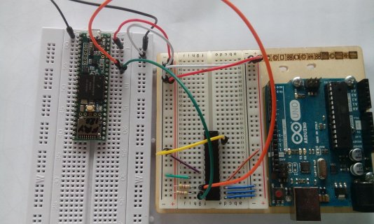

But if it's worth looking into this: I've repeated my experiment and cleared the code.
The testing breadboard looks like this:
Orange should be SCL, green SDA, the resistors are 4.7kOhm,
yellow wire is there for poking around in hope of changing the state of the GPAs...

The MCP's registers are left setup as I need them for my main project, but that I guess should not be an issue,
as they are equally set in both cases.
So, without moving any hardware components (except poking the yellow wire to various GPAs and V/Gnd):
<Wire.h> version consistently prints 255 to SerialMonitor, and never blinks the internal LED 5 times
<i2c_t3.h> version blinks the LED 5 times on each loop iteration, and prints various values to SerialMonitor,
as most MCP's pins are left floating.

with <i2c_t3.h> it works properly with 1.37 (just like before)
The only other I2C device I have is an Adafruit MPR121 touch sensor,
so maybe it's worth noting that I couldn't communicate with it either,
until I switched to <i2c_t3>.
(T3.6 did communicate perfectly with both MCP23017 and MPR121,
using standard <Wire.h> while I was running Teensyduino 1.35)
Further update (it seems I wasn't confused two posts above):
I restart the computer,
Open Arduino and carefully select "Faster", then
Compile and upload
-> It works!
(it's the very first compile/upload after Mac restart)
I then switch to "Fastest", compile and upload
-> Doesn't work
Switch back to "Faster", compile and upload
-> Doesn't work!
And all further cycles of Optimize options and recompile/upload attempts
produce nonfunctional version (Wire.h)

Thanks for the effort manitou. Have you perhaps tried switching the Optimize option?
At the risk of leaving an impression of a psycho,
I've repeated the test with my setup, and everything is perfect if after a fresh restart of the computer I leave the Optimize option at "Faster".
However if I change it, something with the compile/upload gets corrupted and the gadget doesn't work any more - and quit/restart of just the ArduinoIDE doesn't resolve the issue.
I need to restart the complete computer (haven't tried just the logout/login).
So, currently it seems to me it could be either:
- a problem specific to my computer/OS setup, or
- a problem related to Optimize option which maybe goes unnoticed as probably people seldom fiddle with it...
Anyhow, I'll leave this here, if it's of any use fine if not applogies for distracting.

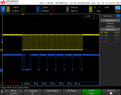

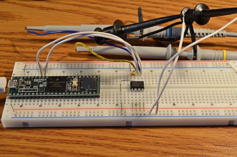

Sketch works with Faster, Fast, and smallest code, BUT fails (returns 255) for Fastest. And as you note, recompiling back to Faster, still fails with 255. However, if i just unplug T3.6 USB and plug it back in, Faster sketch will run correctly with Wire.h.
I think i2c_t3.h has a way to reset the I2C bus that Wire.h does not have. I don't know if i2c_t3 does that reset every time, if so that may be how it clears the problem caused by Fastest ....
EDIT: Fastest also fails on my simpler test sketch with Wire.h. logic analyzer does not even show CLK signal?
your sketch runs ok on i2c_t3 with Fastest
EDIT 2: i installed 1.8.3/1.37, T3.6 with Wire.h still fails with Fastest @180mhz, but now runs @120mhz
EDIT 3: I tested I2C eeprom 24LC128 with T3.6, OK with Fastest@180mhz with i2c_t3.h. Fastest fails with Wire.h @180mhz, but works @120mhz. Faster @180mhz works. So problem is not specific to MCP23017
Just to confirm, I have managed to reproduce this bug with a EEPROM chip at Teensy 3.6 with optimize set to Fastest.
I hope to have a fix soon....
