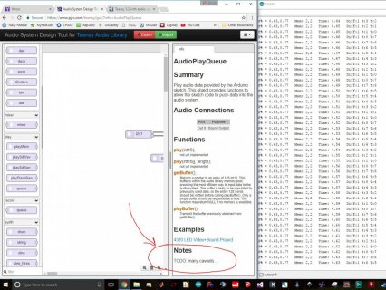

Hey All,
System Overview: Teensy 3.2 connected to SGTL5000, ili9341 touch screen display, and RS-485 on TX1/RX1 for audio retrieval and playback
Problem: Hang up of audio library when calling XXX.getBuffer(); from a playqueue object. Processor hangs up approximately 7 to 10 minutes after power up on the .getbuffer() call. Line 255 of the code below.
Elaboration:
Audio packets come into RS-485 and pushed to audio library for playback. Audio packets come from a remote Teensy 3.2.
The code below fails when calling audio_queue.getBuffer(). Checked this is the hangup point with a scope, as I used the RS-485 direction pin as a visual feedback before and after the function call.

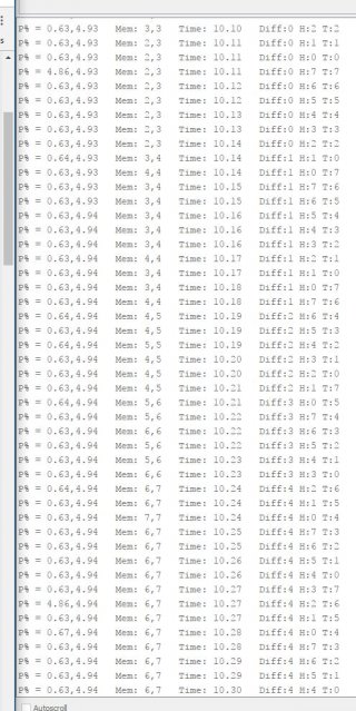

Other indications: about 30 seconds before the failure, there is a spike and subsequent return to normal of audio library CPU usage. After the ~30 seconds, memory usage starts ramping up over 5-10 seconds from the nominal 2/3 blocks to the max audiomemory allocated; system hangs up indicated by a buzzing noise since no more audio packets are pushed into playqueue, and the controller resets due to a watchdog time out.
Troubleshooting efforts:
changing audio memory allocation (tried 4, 8, 12, 20) doesn't change outcome.
Removing the LCD touchscreen routines in loop doesn't change outcome.
Adding delay in loop seemed to improve outcome, except a failure was noted after 26 minutes.
The other teensy which sends the audio packets has never failed and has a similar, albeit less strenuous, interrupt routine to check for audio packets and spit them out over RS-485. The other teensy also doesn't connect to a touch screen or any other peripherals besides the recording SGTL5000.

I am currently running tests and pulling out the head and tail values from play_queue.cpp. Head is ahead by one or two samples for a while, but tail catches up as expected from subsequent small delays of 100uS, and the difference from head to tail runs 0 for a while, then shows the failure signs as the head finally gets ahead of tail again. (Edit: How does it get ahead ? No idea.)
Pic attached. Gonna put some code in playBuffer(void) to make sure the head is always two samples ahead by skipping (old data will be printed?). And as you said, I will have to define the situation when the head moves faster than tail.
EDIT: From Paul's mouth. This might be one of the caveats of playqueue, haha.
Further troubleshooting, being verbose to help reason through my thought process (may be wrong).
Wrapping the audio_queue.getBuffer() with audio_queue.available(), prevents the sketch from crashing. Still however, at random times, between 7 and 15 minutes, the sketch fills AudioMemory. This is interesting to me as the only difference between getBuffer() and available() is an extra if(userblock) check. Audibly the memory failure causes increased amount of chirping as samples apparently disappear.
I pulled out the interrupt time of play_queue.update() and measured the difference between the update() time and the time when I prospectively want to access a audiomemory Data block using .getBuffer(). Memory problems occur when these two times are very close to each other (<45 uS) and they both occur frequently within the same time window.
I am sure that the audio library is very robust, but when concurrent ISR's try to access the same memory location, I can imagine a collision is bound to happen. This leads me to believe that *queue is the source of the problem, and getBuffer failure is only a symptom.
Alot of nonsense work for a small victory...
Went backthrough and read all the audio stuff and interrupt common notes.
I had IntervalTimer, for my main audio collection ISR to default interrupt priority, which was 128. The Audiostream ISR is 208, so the collisions were happening because of the lengthy code in my routines as compared to the more efficient audio library objects didn't yield to the Audiolibrary. I set it to 220 (lower priority than audio object isr's) and it works fine now. Well... I learned me something today.
Happy to report that one test so far is running for over 1hr 20 minutes with no chirping or hangup.
